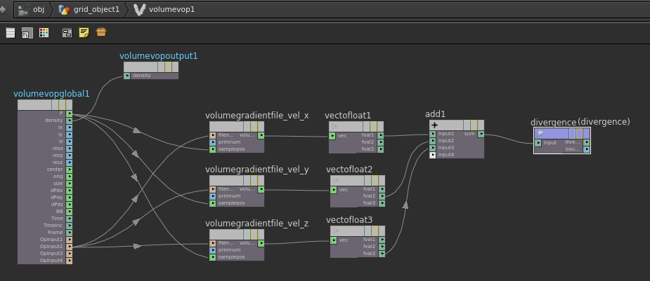

Thanks Jeff for replying. I didn't understand the last part completely. This operation you showed:
float divergence = gradx.x() + grady.y() + gradz.z();
You have to do it for 26 neighbours or just 6? Because you also said:
“You can optimize this by computing the gradient on each axis yourself with volume sample, cutting the total number of volume samples to 6.”
How does that happen? Sorry I couldn't understand these points. Everything else made a lot of sense.

Thanks Jeff it works as expected now
