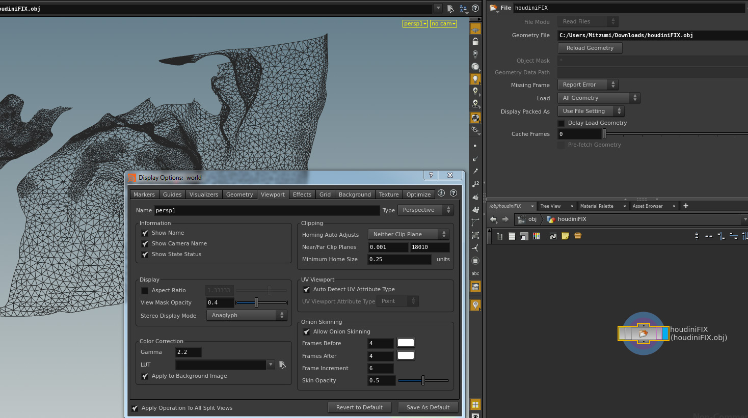

if you use
FILE > Import > Geometry
and browse to your file
make sure that you turn OFF “Show Sequences as one entry” - it's at the bottom/center of the dialog
what this does is allow you to list your files on disk in two ways:
1 - myObj_1.obj, myObj_2.obj, myObj_3.obj etc
2 - myObj_$F.obj - where $F is replaced with the current frame number
but if you only have one obj it will mess up the file path

arctor
if you ever crash - please submit a bug report with as much info as you can
there is no reason Houdini would be able to load an obj from one directory but not another - all things being equal…
and make sure you don't have spaces in your file path…this can often mess things up.
