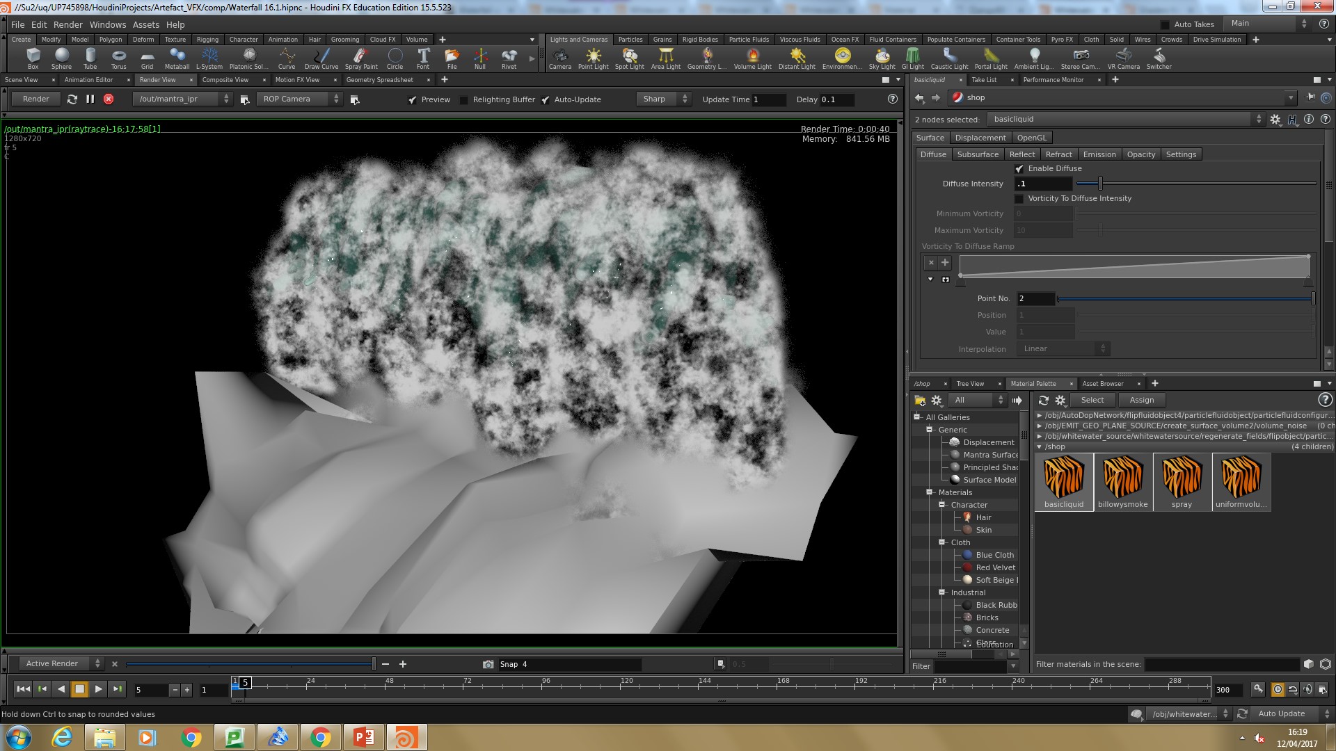

OK after playing around with it this seems to be the best result I am able to get, which is somewhat unsatisfactory. How do I get the results from this image which was done in Houdini? https://i.vimeocdn.com/video/496148453.jpg?mw=1920&mh=1080&q=70 [i.vimeocdn.com] The foam looks much better having spectacularity and actually floats on the surface of the fluid itself.
((Ignore the texture on the base of the model below which hasn't been UV mapped yet.))
Edited by Sneil - Feb. 13, 2017 14:03:34

The way I do it is very slow when rendering but it gives me the most satisfactory results as of now.
Render as small points, around 1 mm in radius, with a water-like reflection, no refraction, opacity around 0.15, faux caustics. Maybe add a little diffuse.
I'd be very glad to hear a faster approach.
*edit. Actually add a lot of diffuse, now that I'm checking.
Edited by A-OC - Feb. 13, 2017 18:32:16

OK so do you change the shader then? Its set up as a smoke shader with no reflection, refraction etc. options available. So it should turn to particles if I do that then? Hmm… I'll give it a whirl anyway. Didn't think to try changing the shader from smoke…
Edited by Sneil - Feb. 13, 2017 19:51:15
253 posts
Joined: July 2006
Yes, instead of generating volumes with the Volume Rasterize Particles, render as plain points. Also assign a default mantra surface and work from there.

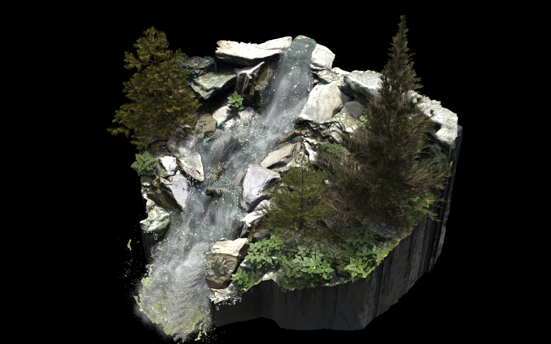

Here's something I'm working on as we speak
Joined: Jan. 2017
Ah very nice. That is exactly what I'm after. So then I am replacing the Volume Rasterize Particles with a Point node? If so I'm not finding any option to change the particle size and they are quite huge when i go to render..
