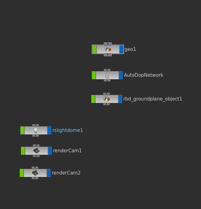

Hi Guys,
Who can give me some advice?
I'm trying to render a simple RBD scene with Redshift. Somehow the rbd objects won't show up in the render.
If I render with Mantra, the rbd objects do show up in the render. Redshift probably needs a special workflow for this??
As a workaround I tried to cache out the rbd, but since I'm still quite new to Houdini, I couldn't figure out how to do this. I tried some ROPs and file cache but without luck.
scene_01.hip (398.8 KB)
2625 posts
Joined: June 2008
Turn off the Display flag on the AutoDopNetwork and create a geometry node to import the result of that network. Then Redshift can render those objects.
Edited by Enivob - March 11, 2017 21:40:00
ap_rs_scene_01.hiplc (399.1 KB)
Using Houdini Indie 20.0
nVidia 3050RTX 8BG RAM.
18 posts
Joined: Jan. 2009
That's the advice I was hoping for!!
tnx Enivob!
