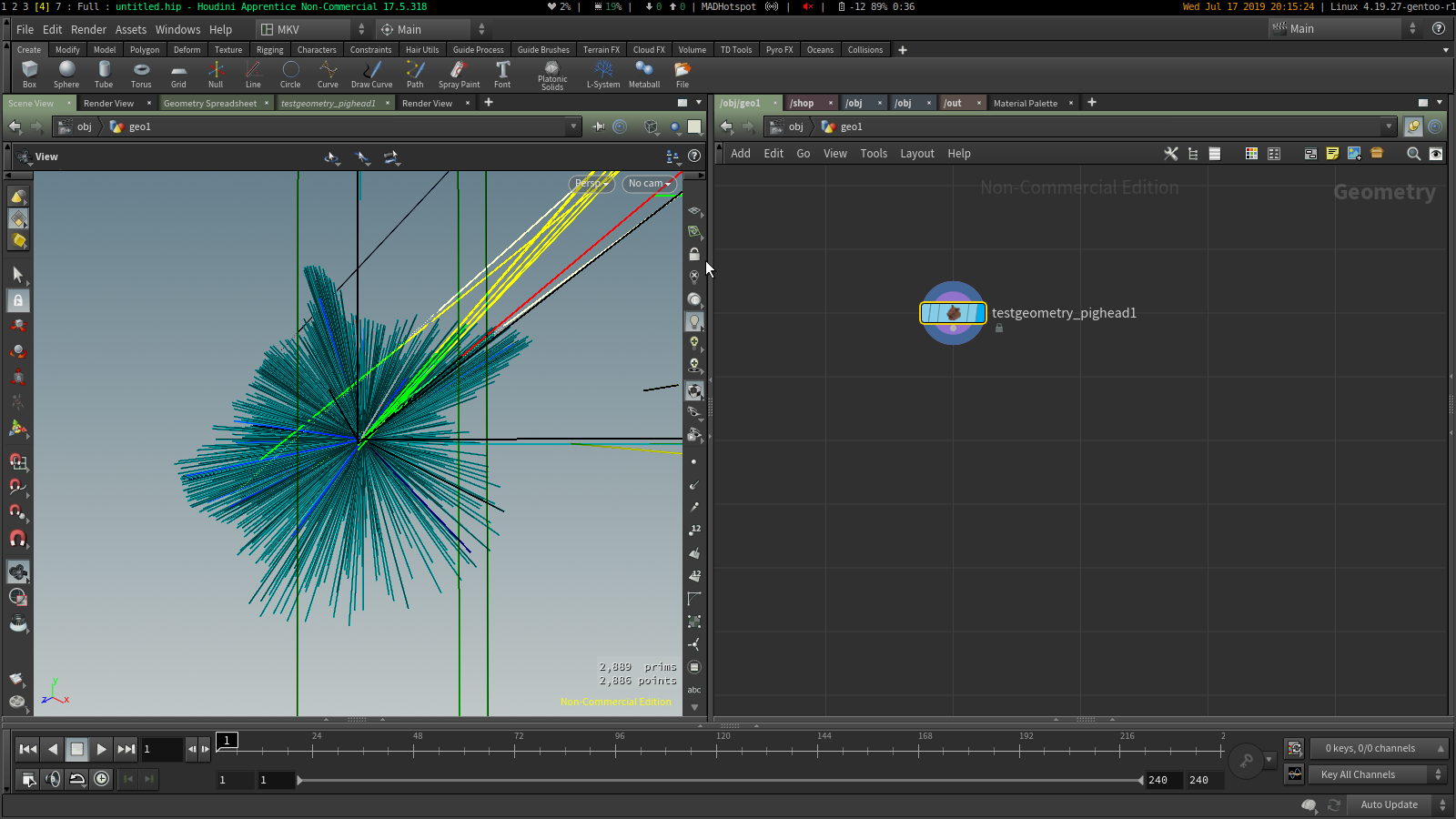

Since some time ago, I am getting weird viewport glitches when using wireframe display mode on my linux laptop, when running houdini on integrated Intel GPU. It looks like this:
Any ideas what's going on here?

What internal GPU do you have? Did it ever work before? Can you test older Houdini versions?
I can see you're running on mesa 19.0.3.
I have the same problem. I tried mesa 13,17 and 18 so far. Always with the same problem.
I also just checked Houdini 16.5, 17.0 and 17.5 of course.
Anyone here who can help? There is no option for me to install a dedicated GPU, since it's a remote machine.

It's an Intel integrated graphics, VGA compatible controller: Intel Corporation 3rd Gen Core processor Graphics Controller. And yes, it used to work before, as I remember.

Is there any chance to find out when it worked?
Did you upgrade your drivers at some point? Switched to mesa from something else?
Is it the houdini version maybe?
325 posts
So, I checked the bug(?) against the houdini installations that I have on my laptop, the earliest 17.5 I could go to was 17.5.173, which showed the same viewport glitch; I also have some beta versions that I can not run any more, so I can not tell if the bug(?) was earlier in 17.5 or not. However 17.0.352 runs fine and shows no glitch.
Could it be related to line smoothing? I see that wireframe is not smoothed in 17.0 build, on the other hand, in 17.5 builds lines are smoothed and the viewport shows glitches.
