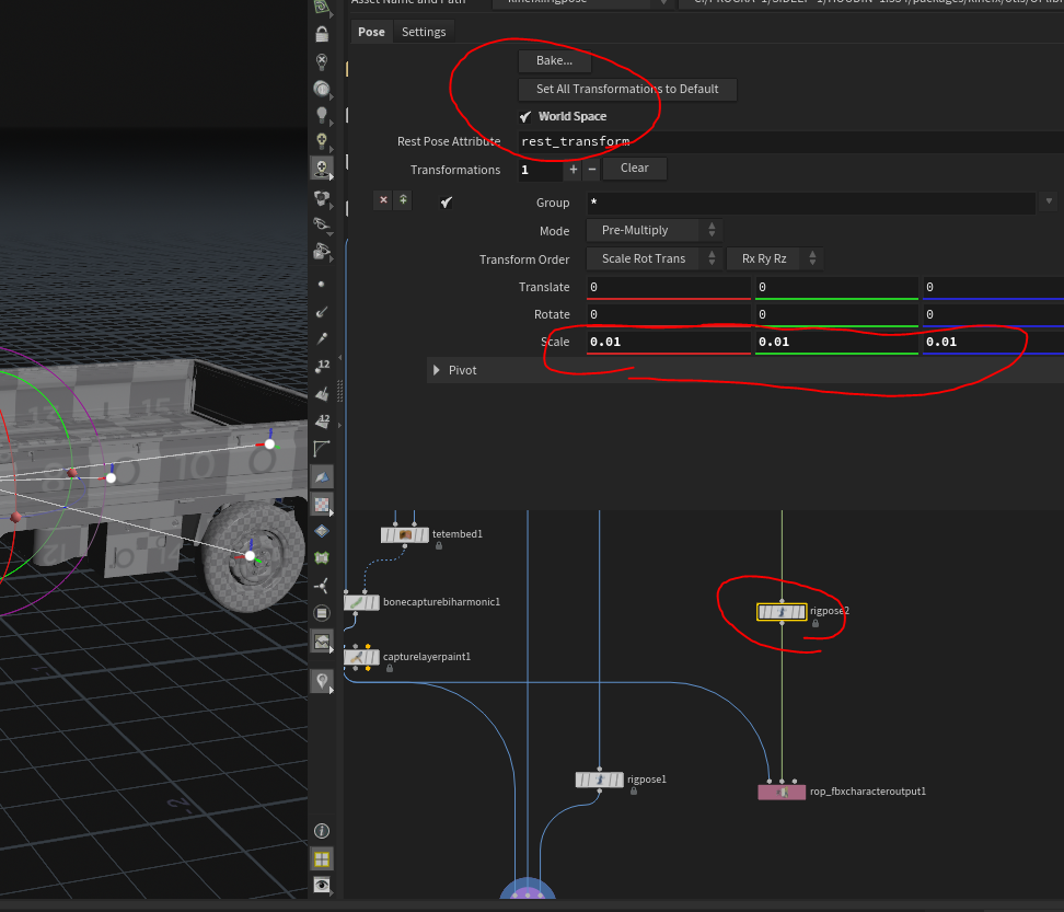

fellow named will on the Think Procedural discord server helped me
there is not a single word about this mentioned in anywhere, so sad feel bad
fix "add a rigpose, set it to world transform and scaled everything to .01 before export"

You can also divide the transform of the skeleton with a simple point wrangle node. The equivalent to the rig pose node would be:
3@transform /= 100;
Then do that for both the rest pose and the animated pose.
I made a quick tutorial about this same topic because I also was really confused, you can see it in here:
