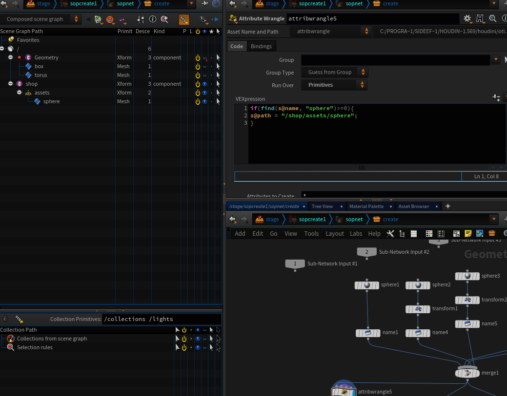

Hi i want to add objects to specific path based on there name using vex i write something but its merging mesh in to one object any help is appreciated i am attaching my file with this thanks!
if(@name ~= "sphere*"){
s@path = ("/shop/assets/Sphere");
Edited by vipinfx - July 5, 2023 13:05:00

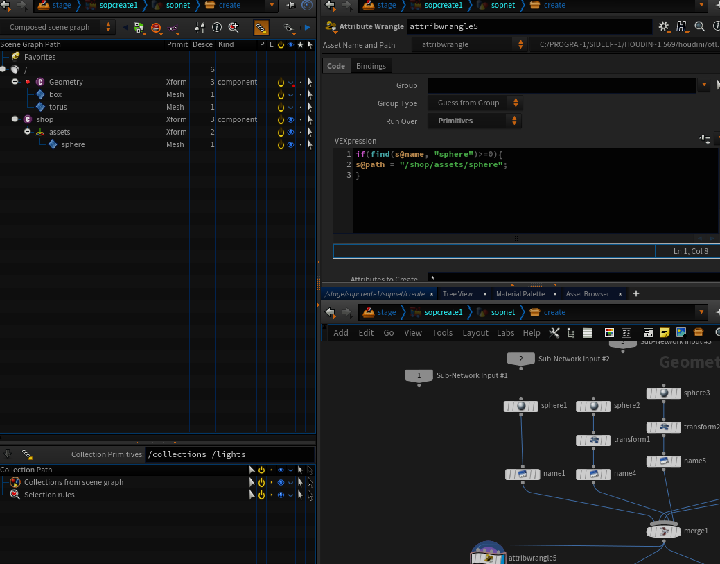

I would go like this:
if(find(s@name, "sphere") >= 0){  // if it finds the word sphere, it will give a number above zero
s@path = "/shop/assets/Sphere";

Thanks for the reply olivierth , the result is same for me.. its merging anything that names sphere in to one object mesh instead of adding them individually on the xform

to avoid merging, you would need to add the existing @name to the path
s@path = concat("/shop/assets/Sphere/",s@name);
Edited by Mohanpugaz - July 6, 2023 03:53:57
