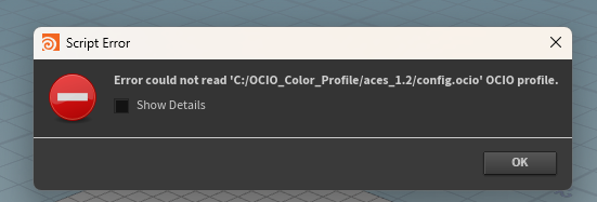

I went and deleted the variable that I created following that tutorial and then houdini decided to give me this error.

Houdini uses packages to setup the user OCIO environment variable. You can add your OCIO package manually to your user folder like the one below to tell Houdini to create and set the OCIO environment variable with the settings from your houdini-config-v2.1.0_aces-v1.3_ocio-v2.3.ocio file.
Or simply use the OCIO editor (Edit|OCIO Settings...) to create the same user package the first time you save your settings.
{ "enable" : true, "load_package_once" : true, "env": [ {"OCIO" : "${OCIO-C:/Users/bob/houdini21.0/ocio/houdini-config-v2.1.0_aces-v1.3_ocio-v2.3.ocio}"} ] }
