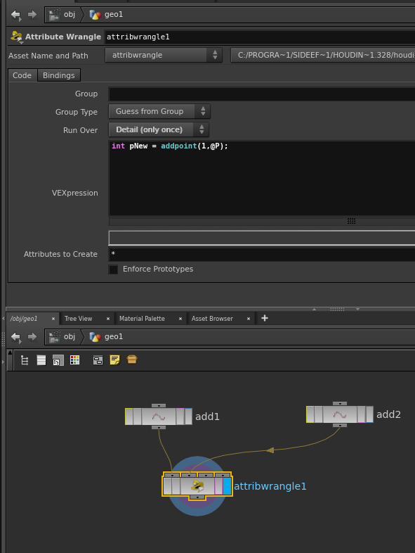

I was wondering about the fact that each VEX function has a geohandle like this:
int addattrib(int geohandle, string attribtype, string name, int defvalue)
Does it mean that I can also modify incoming geometry other than the 0 / geoself()?
If yes, is there a way to address the modified content somehow?
More practically something like:
Is there a way to create a secondary output for a wrangle / attrib VOP?
I hope it made some sense.
Modification on opinput other than geoself()

That parameter is there for future compatibility. If we didn't have it, we'd have painted ourself in a corner in the glorious future when you'll be able to edit other geomety's than your own.
Unfortunately, we do not yet live in that glorious future.
(My dream is to allow the Attrib VOP to have multiple outputs which you target with 0/1/2/3/4… But it is but a dream…)
