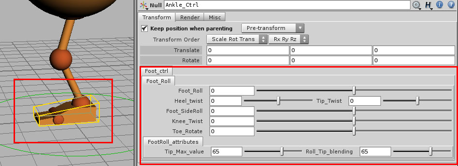

Hi Goldleaf!
It didn't change from the old version to the new, it is in there since day 1
It's all in the Ankle_Ctrl, take a look at the picture attached….
Not only it can do what you ask for, but when you play with the foot roll slider it already gives you a foot rotation in X from the heel to the toes.
The foot roll attributes tab sliders, give you extra controls to play with the footroll rotation angles.
You also have the foot sideroll slider to rock your foot from one side to the other with the good pivot on each side…
the rest of the setup is really standard stuff…
You should download the new version and give it a test drive for a couple of hours, I also added the needed channel groups for animation in the channel list.
I hope this helps, and hope that this actually works for you!
Thanks alot for the comments!
