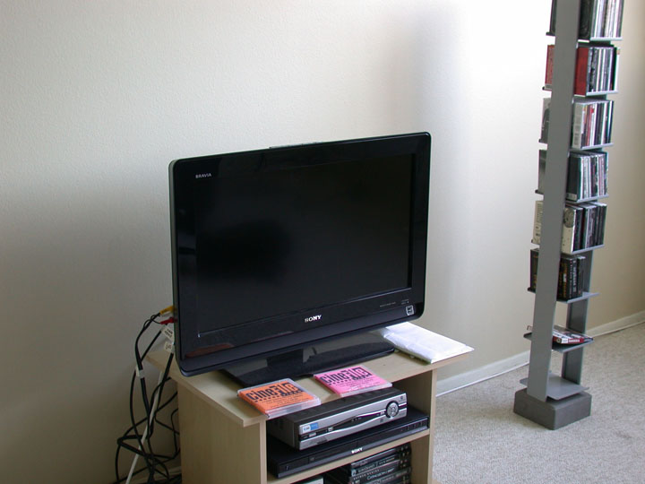

I'm trying to composite an image into a photo of a television set. I managed to place the image correctly. However, I lost all of the great reflections, etc. from the original plate.
In my scene file, I managed to matte out the screen without the image, but I'm not sure how to combine it with my comp. I have been trying to create an alpha matte with a ramp, but, so far, I have been unsuccessful.

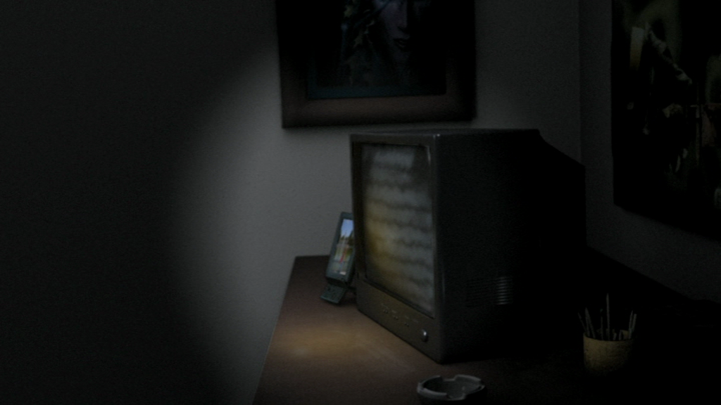

I've sent u a picture of what I did for my own project!
