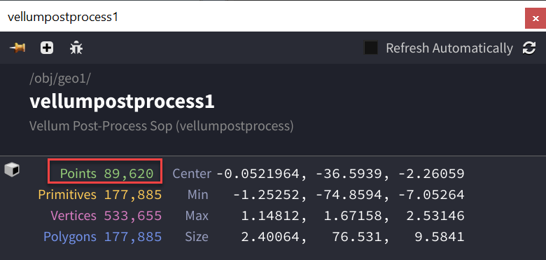

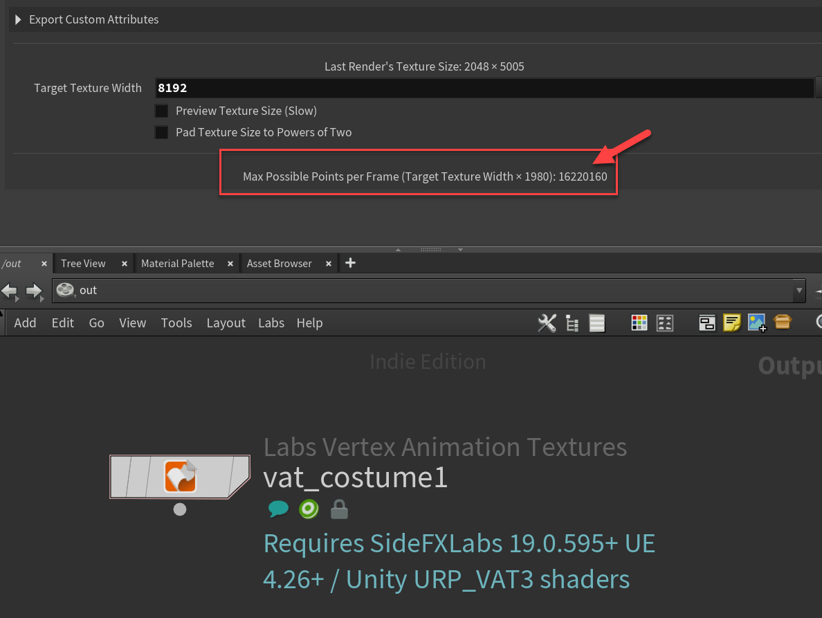

I am seeing errors when I try to export with 89,620 points on an 8k mesh using Hou 19.0.622. The vellum sim is 1000 frames long.
The node says that the point limit is 16million+
If I chop the asset into 9k point count chunks it seems to work.
What is the math used to determine what is the best texture size per point count?
What are the limitations on point count?
Can whatever math be used to engage a warning before rendering if it's not going to work?
Right now it feels like a lot of trial and error and it just seems to be having the appropriate combination of point count + texture size.
