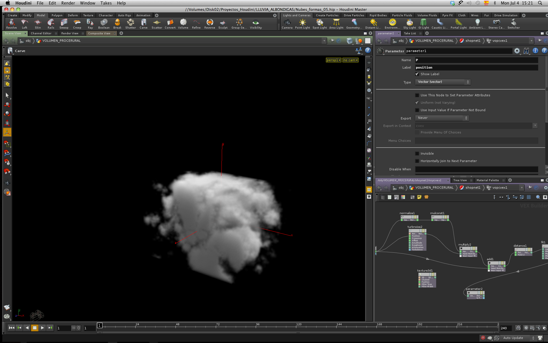

HI EVERYONE IM WORKING ON A PROJECT,I HAVE TO PUT SOME GEOMETRYS
IN THE SKY WITH A CLOUD FORM.
I SAW THE CMIVFX TUTORIAL,FOR THESE CASE IN PARTICULAR,AND ITS VERY COOL,THE AUTOR CREATE A CLOUD,THATS ITS EASY,AFTER CREATE A ISSOOFEST WITH A BIG RESOLUTION AND MAKE TWO I3D ONE FOR DENSITY,AND OTHER FOR GRADIENT,AFTER IN THE VEX OR CLOUD HE LOAD IN THE VEX SO THE GEOMETRY TAKES THE CLOUD FORM,
THIS LAS STEP,ITS IMPOSIBBLE ,THERES A BUG AND WHEN I TRY LOAD THE I3D THE IMAGE DISSAPEAR.
HOW CAN I FIXED THAT??
ARE OTHER WAY TO MKAE THIS EFFECT??
FOR EXAMPLE A TITLE WITH CLOUDSHAPE
THANKYOU FOR READ ME AND HELP
BEST REGARDS AND SORRY FOR MY ENGLISH
CLOUD SHAPE

Hi, just in case…
Did you “expose/create” parameter for your file?
i mean, did you setup the path of your i3d files outside the CVEX network?
in cvex context (i think in any vex context) you cannot use “expressions”
like $F.ext for example…
And, yes you can use a isosurface directly instead i3d, there's a node called volume sample from file, you can use same setup that CMIVFX, also you can manipulate your iso in SOPs with Volume Vop… there's a good topics of Volume setups around sidefx and Odforce forums…
cheers
