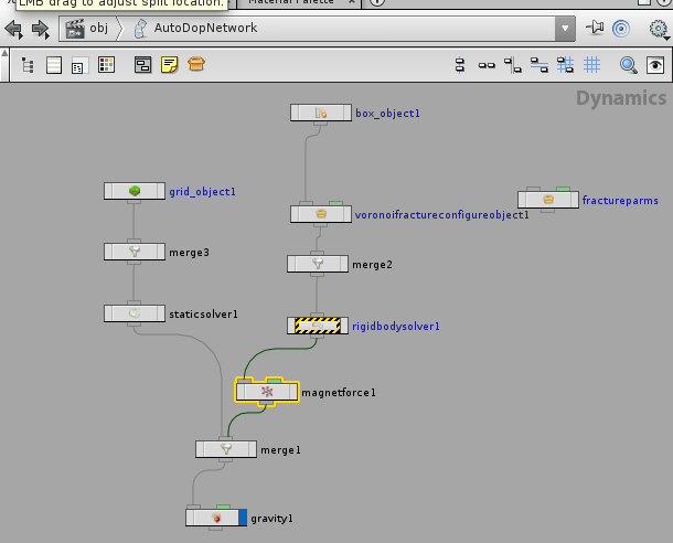

Thanks asnowcappedromance and VFXCSN0309,
I've been trying to implement your advise and I seem to be getting stuck.
4,Set this box as auto fracture tool from the shelf
I can't find the auto Fracture tool.
6,Put down a magnetforce node and a SOP Geometry node.
Magnetforce goes into the Dynamics/DOP and the Geometry node goes into the scene level/SOP?
8,Connect SOP Geometry node to Magnetforce node, and connect magnetforce node directly into the main chain
-how do I connect a metaball within the box node to the geo node on teh scene level.
I have pictures of the different levels so you can see where I'm in error. Please let me know where the connection is not correct. Thanks.
