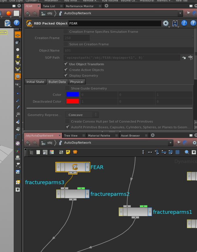

Here is a screen grab. It seems to “infect” other nodes in the same network. However, I found that if I make a copy of one of the “offending” nodes everything comes back to normal for all the other nodes that were locked.
Houdini, has a lot of things it likes a certain way and I don't want to presume that it's not me doing something it doesn't like. That said, it does seem kind of random.

Are you perhaps using Houdini vs Houdini FX, accidentally?
