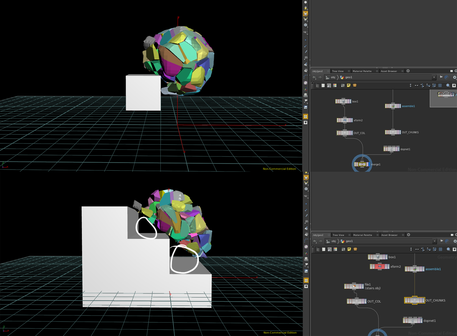

I'm new to Houdini so this might be a very silly question.
I'm playing with Voronoi Fracturing.
Got it simulating with a small cube but when I replace that cube with a simple stair.obj model, it seems there is some gaps.
(619.9 KB)
foam
16 posts
Joined: 4月 2012
2014年11月30日 21:52
On the static object under Collisions > Bullet Data, there's a ‘Show Guide Geo’ toggle that you can use to visualize the collider.
It's probably doing what you're showing because it's represented as a convex hull. Changing it to concave should help.
