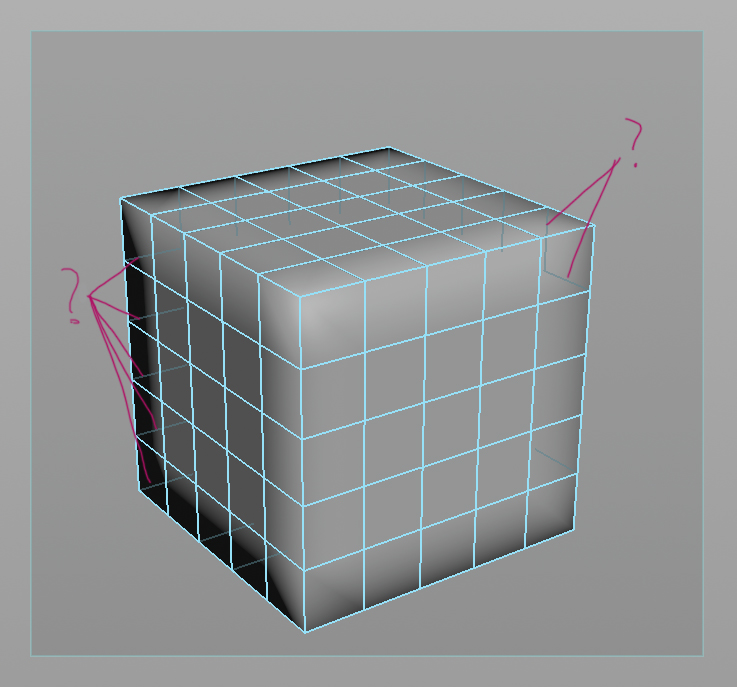

I'm going to corner you in this thread instead of opening another, as it is something I've submitted a RFE to but if my memory serves me well I haven't got a response from support.
It has to do with the rectangle select tool for edges. Take a look in the attached image - it seems that the selection catches the edges from the other side as well (which are caught varies with the angle the camera is looking at the geo). It's almost like there's a pixel there that gets the attention of the selection rays.
Polygon selection suffers as well, but to a lesser degree - fewer polys are selected.
This is a serious issue.

@grendizer, I can't reproduce the issue in your video. This could easily be a video driver issue. You'll need to open the Help->About Houdini dialog, click on Show Details, and Save that info to a file. You should probably submit a bug with the info, and posting it here too would be good. Thanks.
@McNistor, I wasn't able to find the bug you mention in our database (our search tools aren't the best) - have you got a bug id for it? Or was it just something you posted on the forum?
I can say that the basic explanation for the behavior you're seeing is that the points at the ends of the edges “around the corner” are technically visible, which is why they get selected (when selecting edges we actually do a point selection as well as looking for the edges themselves). For now, if you switch from “Select Front and Back Facing” to “Select Front Facing Only” those erroneous edges should not be selected. But that setting presumably would lead to other unwanted behavior.
I was also unable to reproduce the problem you are reporting about not selecting edge loops without shift in 14.0.444… I just put down a torus, go into edge select, A+MMB-click, and the edge loop is selected. Any other hints on how to reproduce?

Here's hoping the shift-click issue doesn't come back…
Our support department couldn't reproduce the hidden edge selection issue, so it never got promoted to an R&D bug. Since I was able to reproduce, it has now been added to the R&D bug database. I can't speculate on a timeframe for fixing though. It is likely to be a challenge to fix it without breaking other aspects of our selection. But at least its on the radar now.

Ah, I see.
It is a rather urgent matter as far as I'm concerned for any modeler and as such I hope this will get sorted out sooner rather than later since it makes “select visible geo only” kinda half-useful when in edge/poly selection mode. It makes one be wary to always check out the selection on all sides and deselect whatever is unwanted - brings back bad memories from Maya.
