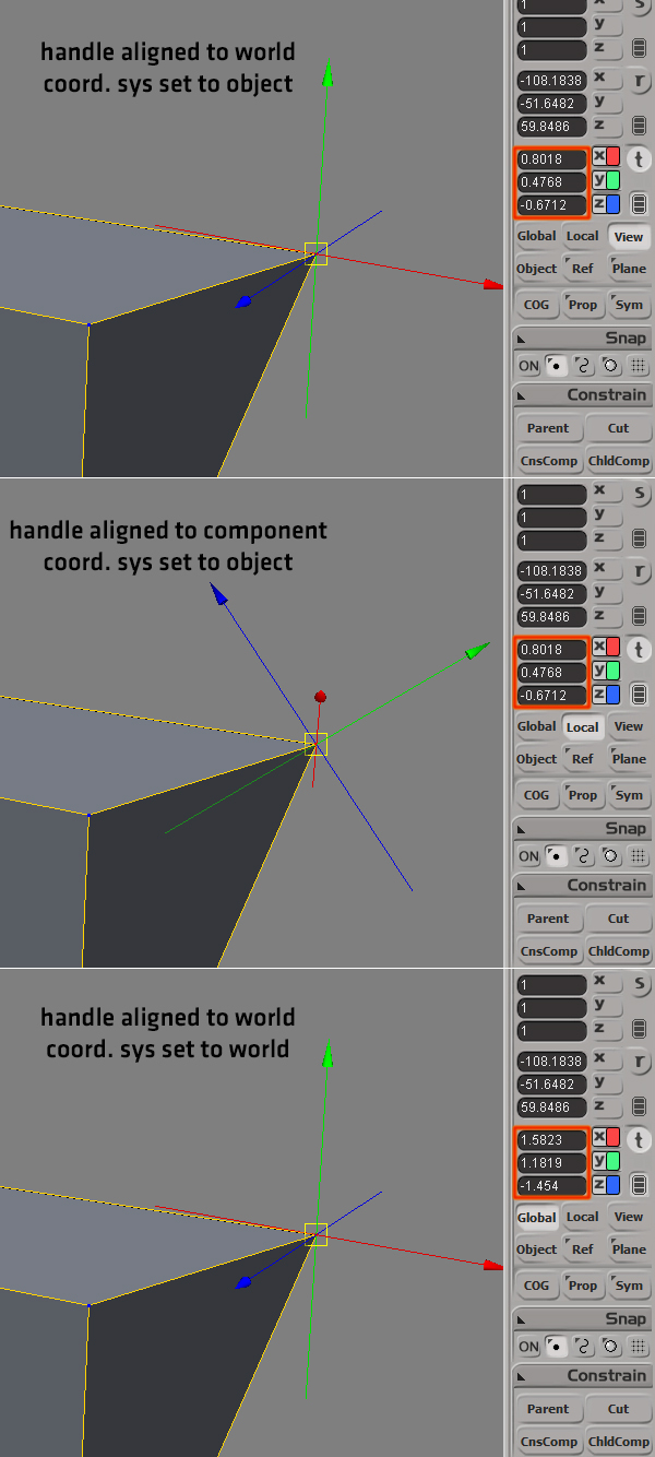

If I select a point in Soft (pretty sure it’s the same in Max and Maya) and I want to translate it to (5,-5,5) in relation to the center of the world, I switch to “global” and simply input the desired values.
Did something changed in meantime in H or is the Spreadsheet the only way of doing it?
Seems like in Houdini the Handle Alignment is just that - an alignment, it doesn't change its frame of reference.
Softimage does have two modes which are just an alignment, view/object (gizmo aligned to world) and local (gizmo aligned to component), of which the frame of reference is the object center but also a global mode with the gizmo aligned to the world and ref. sys set to world.
Kinda of a bummer, this makes it downright impossible for me to pick Houdini up for modeling if I don't have this flexibility at my finger tips.
I think any modeler coming from outside would be dumbstruck by this… I strongly believe any planed modeling features should be put on hold a bit and deal with this uber important issue. I wish so much to be wrong on this one and Houdini to have a quick easy solution to this already.

We clearly need an easy to use solution, something like I've described in the above image.
Using wranglers to do this is kinda crazy as well - I can imagine someone working in archvis trying to scale complex objects at SOP level by moving points with the intention of achieving some given dimensions using wranglers - it's not looking good in this thought bubble of mine.

I'm not sure I understand what you mean by you want handle parameters to tell the handle to behave as if the user moved it to a specific location.
I want to be able to move components and objects in global space, by either dragging them in the viewport or by entering values manually which implies displaying the position in relation to the center of the world.
Make sure you analyzed the attached image above as it's worth a thread of words.
These are extremely useful features, bumping up productivity not only in modeling, but in rigging and animation too.

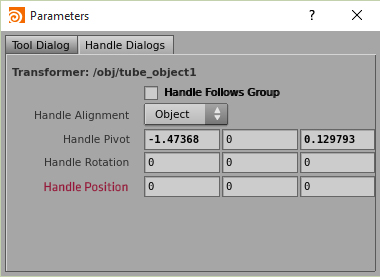

This might be a stupid question as I'm clearly not familiar with the vernacular - a field as in a row of value boxes, other than the current TRS ones? That is under Handle rotation and pivot in the Handle Dialogs window?
If that's what you meant, then think about the fact that an Obj (or component) has to have Local (already present), World, Parent and Reference (to be picked by the user) coordinates (for all transforms, TRS) displayed based on the handle alignment.
These coord. havbe to be displayed in the Op. param. window, in the same boxes the current local ones for the sake of simplicity.
