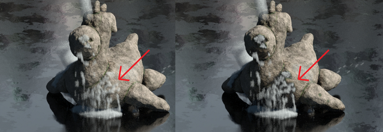

Hi everyone,
It's about the new dirt mask node in shop. How can I limit the dirt to be affected only by the object itself ? I have two objects touching each other, and one object affecting the dirt mask of the other object. I was thinking that it was in the scope parameter, but it's only working with the * and it doesn't resolve my problem, it seems that I can't limit this to one object.

type scope:self into scope parm

Working great !

Well it seems that the “scope:self” is only compatible with the Ray Tracing engine, but not with PBR… Is it correct ?
With PBR, and with the “scope:self”, the dirt mask just disappears.
