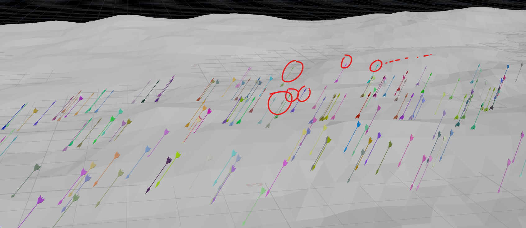

SteveSayerI was doing this and thinking about the soultion of correcting hit alignment.
Hi, folks.
here is what i have done, buts it s not doing well in may set up some are getting reverse in directions and they are snapping in an angle , may be using some randamizations of the rotations can help that same angle to reduce, but cant figured out why some points are flipping opposite diections, its happening in the sim itself i tried using normal ground plane as collider, then its not even using hitnoraml.
v@N = v@v+@hitnml; after the pop sim
after digging into the pop solver I am guessing it is the gas integrator node which is causing this collision alignment.
I though about the sop solver or for each point to get the previous frame of the stopped = 1 to get to the alignment,
suggestions are much appreciated in this case to get the right alignment after the hit and stopped or stick.
trying the collison scatter points and attribute transfer might not working as the particles can hit any other direction then the Collison point oriented directions
a flip book of the hitnml use https://youtu.be/xSS5o9XOcS8 [youtu.be]
Edited by Houdini Obsession - 2021年5月8日 18:20:28

SOLVED
by using the POPdcollisiondetect with option of sop or context input(while using the dop object option it is same as the pop solver) and (with popsolver node off/uncheck the enable collsion detection ) this is making the orientations steady while using the popsolver node it is changing the orientation to the collision geometry and some times flipping them.
