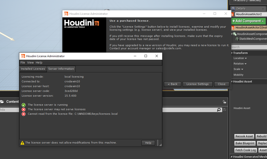

The plug-in is present. I can pull in the asset. However, I get a quest for a Houdini Engine license:

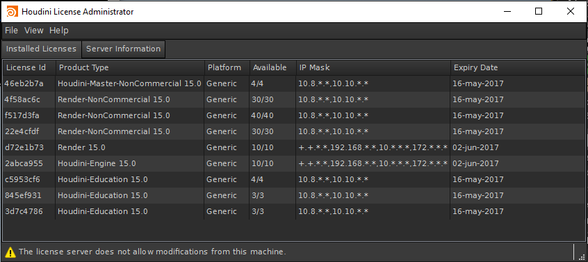

I open the options and I find that the I have lost contact with the license server.
I try to change the license server but the interface will not allow me.
We have ample “Education” and “Engine” licenses but when I try to access through UE4 I loose total contact with the license server.

This is not the best solution but it as at least working.
I uninstalled UE4 and Houdini then reinstalled them in that order.
Now UE4 brings in properly built assets just fine. I tested with the spooky staircase .
I'm not sure what changed but it seems to work now.
