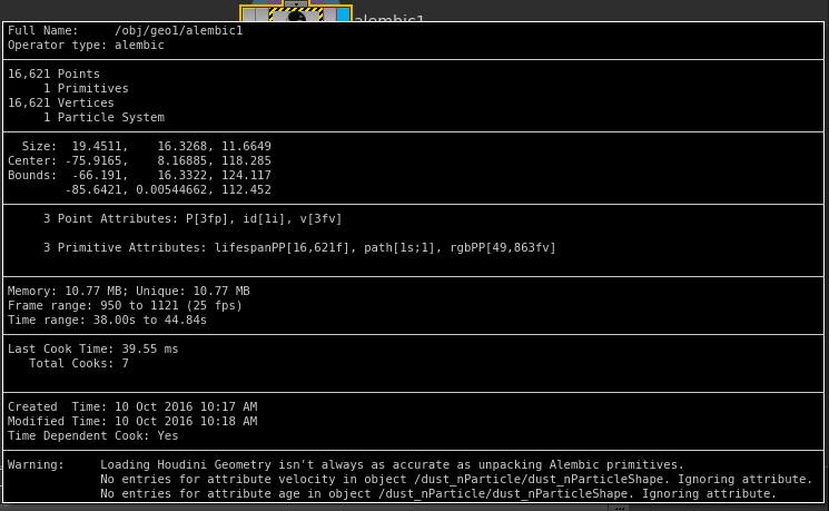

Right. What I am trying to do it take some nParticles from Maya over to Houdini for rendering in Mantra.
I am using Alembic to transfer the particles. Houdini finds the particle position, P, velocity, v, and particle ID, but not other per-particle data, such as rgbPP, lifespanPP, aimDirectionPP, etc, which I would like to carry across.
I can see that some data is there in the alembic file, but Houdini does not seem to be translating it properly.
Maybe you can see from the screen grab what is happening.
rgbPP, for example, is coming in as a massive array of floats, the size of the array is three times the number of particles.
I assume I need to wrangle the Alembic data in some way. I would be very grateful for some help with this.

I'm sure this question must be a common one but I have searched this forum without finding the solution I need. So, apologies if I am repeating a previous post.

Hello again,
I have been given a clue to solving this problem, which is to use the Attribute Promote node, which will move the rgbPP attribute from the primitive, to the particle context.
Now, I'm not entirely convinced this is correct, but let's go along with it. Here is what happens:
Maybe you can see what is going on.
I have applied the attribute promote node to the alembic file, now I get a massive array of Cd on each particle. In the spreadsheet, the Cd columns go on and on until n = 3 * number of particles.
