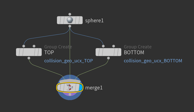

I've attached an image with a simple example:
A sphere with two convex hull colliders, one group with only the top vertices selected, another with the bottom.
The collision groups are invisible (collision_geo_ucx) and merged with the sphere geometry.
The end result is a single sphere mesh, with two convex colliders.
If I had used complex colliders (with groups called collision_geo_top and collision_geo_bottom), I would have had 3 meshes, the sphere, and the two non visible colliders.
