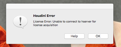

When I start houdini,that always show “License Error Unable to connect to hserver for license acquisition”
But I can find it in services
What is Wrong?
I am OSX 10.11 platform
A question about hserver start ,help!!

Either hserver is in a bad state or network communication is being blocked.
Try restarting hserver. Easiest way to do that is to kill the existing one and then run Houdini. Houdini will automatically re-launch hserver.
The other thing to check is System Preferences -> Security & Privacy -> Firewall. If the firewall is on you can either temporarily turn it off (for testing purposes) or allow incoming connections to hserver.
