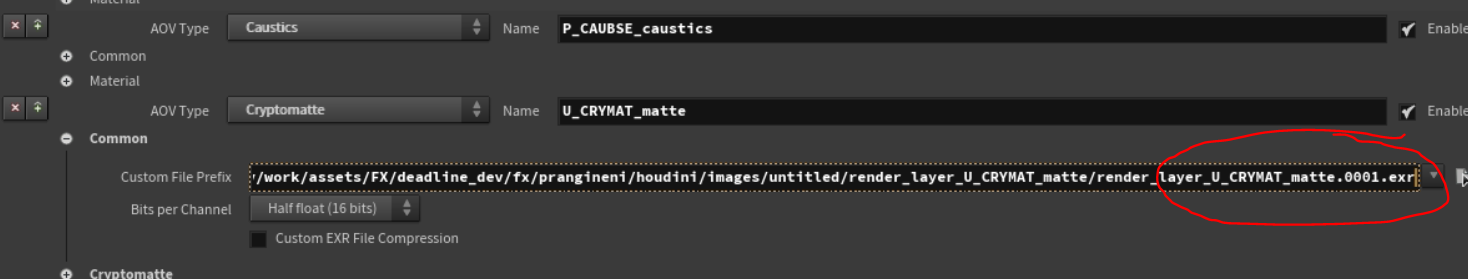

I'm trying to save the Cryptomatte AOV from redshift in a different path and I have the "Custom File Prefix" setup as shown in the picture.
When I save it, I was expecting the layer to be saved as "name.$F4.exr". Instead, it's saving as "name.$F4.AOV_layer_name.exr"
Any idea how to fix this??
Joined: 11月 2015
Looks like we have to use the $AOV tag to place the AOV name at any point of the file name prefix. Otherwise it just appends it before ".exr"
