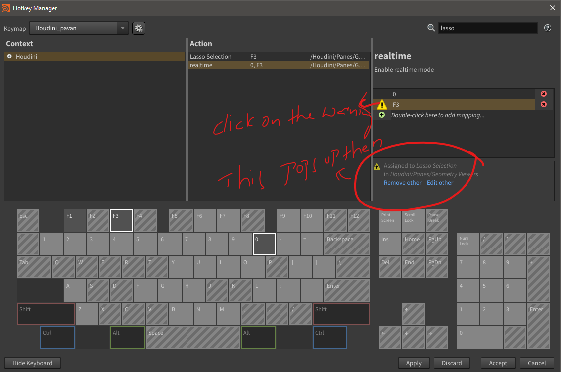

shift + ctrl + alt + middle/left click on a command or tool or shelf tool or an menu item you want to assign it and if the hotkey manager pops up then it is possible to assign a hot key,
if hotkey manager not pop up, then 'cannot assign hotkey' will be shown up in the status bar
eventually u can find out which can get hotkey or not from here.
when u are assigning a hotkey for a command if that shortcut combination is already exists in default shortcuts it rings up an warning badge in triangle, hit that warning with left click and it shows up the existing commands of the shortcuts
