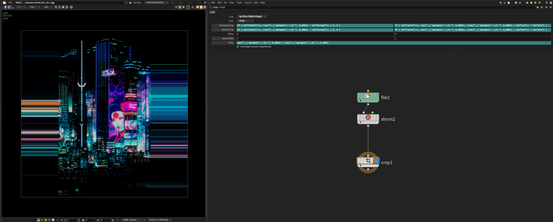

Joined: 2月 2021
SOLVED
For anyone looking for the same thing. This is what I came up with. Just replace resx and resy with your resolution or aspect ration. Then use the same resolution in a scale node. Thanks mestela for pointing me in the right direction.
Screenshot from 2021-09-01 23-03-29.png (48.8 KB)
