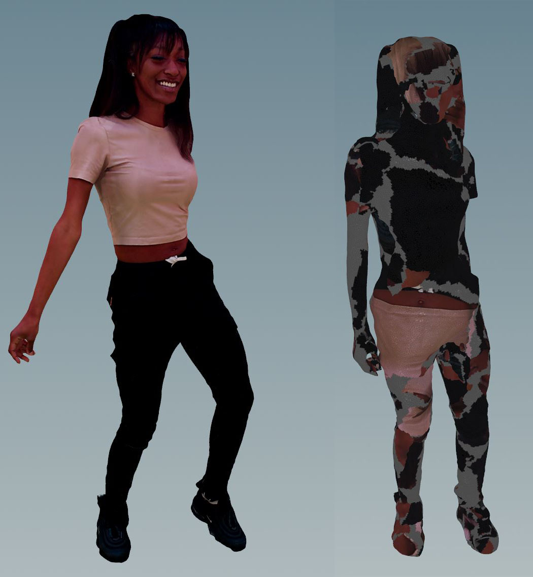

Really hoping for a fix on this soon. I'm trying to run volumetric video (mesh and texture sequence). Sequences won't line up in viewport or render (both SOPS & LOPS). Works perfectly in 18.5, breaks every time in 19.0.455.

Joined: 4月 2014
I still have issues. I am getting desaturated textures, B&W and it's more often than I'm getting color. It happens in viewer and in render.
