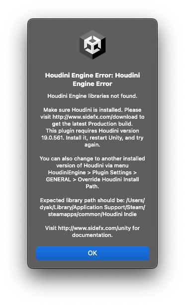

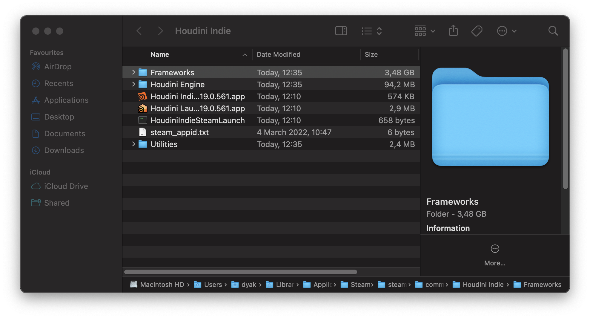

I'm trying to setup Houdini Engine for Unity on macOS (Monterey) and I have some troubles with installation paths. I'm using Steam version of Houdini Indie and everything installed well, but it looks like Houdini Plugin can't see any of installed libraries.
At first, I was trying to setup installation path through environment variables, but it looks like plugin is trying to use predefined path anyway (HEU_HoudiniVersion.HOUDINI_INSTALL_PATH). So I've changed it by replacing default user name with my actual user name, but plugin can't find libraries anyway.

same error here. apple silicon MacBook Air. I have stucked for a month. No problem on my PC or my Intel chip Mac.

Looks like it may be a bug. Please log a bug with as much info as you can. Thanks!

So there is problem with loading Houdini libraries through Silicon version of Unity. I've installed Intel version of Unity and looks like problem is gone. Silicon version of Houdini is currently in preview and has no Houdini Plugin support.
