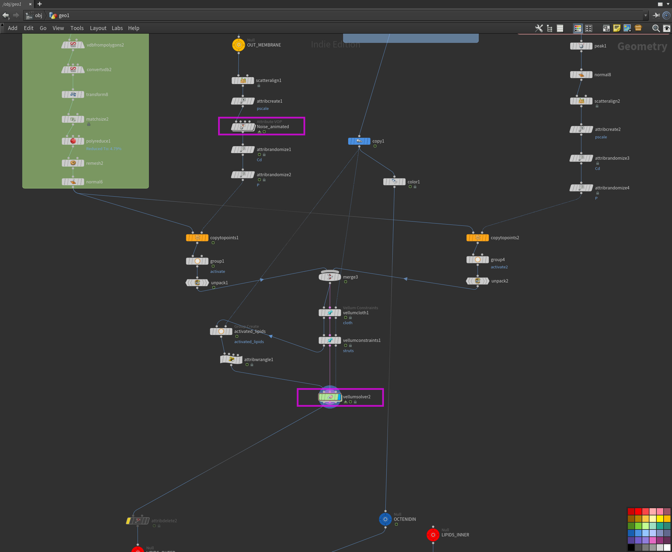

I have a noise animated surface and a vellum setup which is perfectly working until it comes to the vellumsolver node. There it becomes static.
Does somebody knows how to keep it working?
I attach a screenshot of my setup.
Thanks in advance.
Noise animated mesh stops working in Vellum Solver

A simplified hip that contains the core of your problem is usually a better way to get answers.
That said, it's pretty common behaviour for houdini simulation to only read the first frame of your geometry, or to use it to emit stuff within the simulation, eg particles.
For vellum, a vellum rest blend node inside your solver is one of the more common ways to make your sim follow your object. Set the mode to 'every frame', set its target to your sop geometry, and dial in the amount. There should be lots of tutorials around, Paul Esteves has some nice quick ones that should get you started.

Still can't figure out a solution for my problem.
As a beginner I was able to setup this vellum animation (attaching mp4) with noise animated surface and vellum sim. But when it comes to see all together activating the vellum solver.... the noise disappears. And I am not able to figure out what to do.
Any ideas?
Any ideas?
