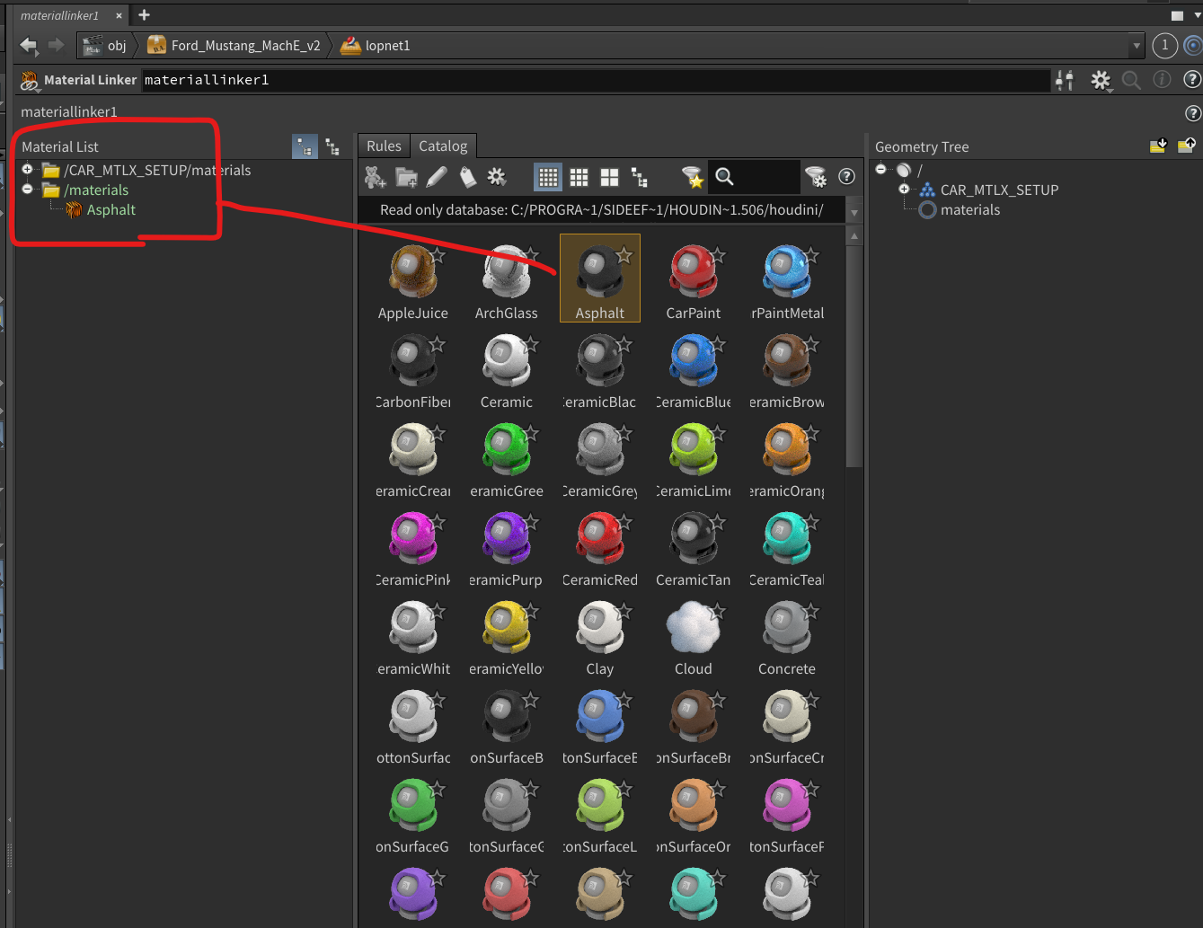

I'm playing around with the new Material Linker node using the catalogue of included materials. It's all pretty neat and intuitive so far.
However, once I drag a material from the catalogue over to the Material List (which also adds it to the Scene Graph), is there actually any easy way to simply remove it again if I change my mind and don't wish to use it anymore? Maybe I'm blind, but I can't seem to find any delete, undo, remove and such on that panel. I can see that it's simple enough to remove the rules once added, but I can't figure out how to remove the materials themselves.
Thank you!

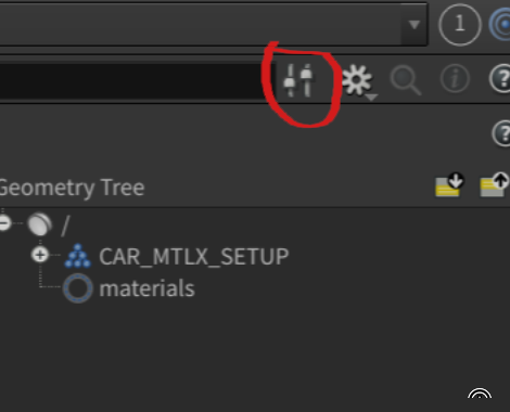

The linker has the ability to hide and display parameters in a more familiar form. It may not be as convenient as a menu item, but it works.
11 posts
Joined: 10月 2014
alexwheezy
Exactly what I was looking for, thank you very much! Although I must say it's not a very obvious button.
