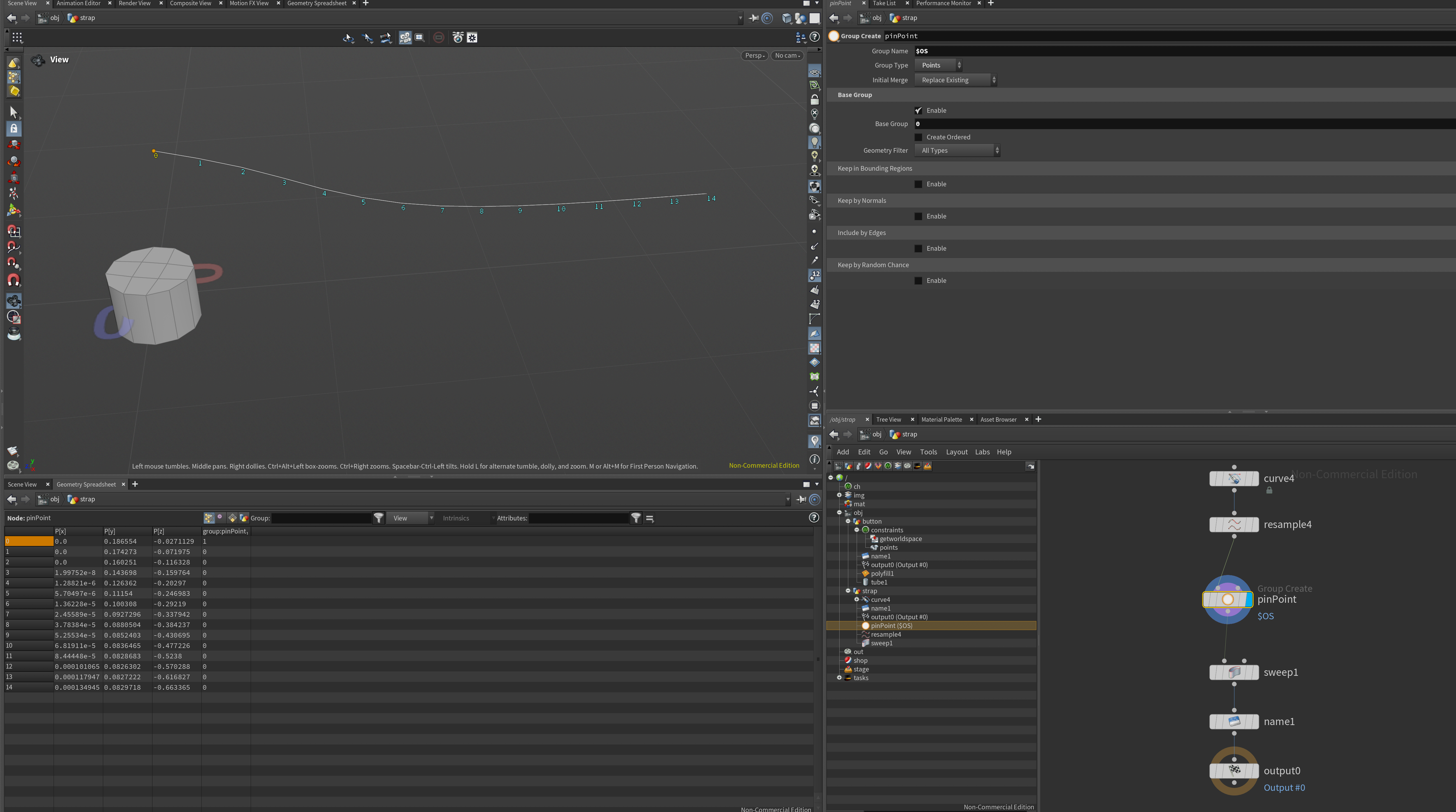

I'm not sure to use right the Points Constraint, so when I use a integer value directly (for points for example) it works as expected, but when I provide the path for the group containing the point(s) doesn`t work.
Any tip?
Thanks

The path is already specified so don't try to specify it again. The group syntax is documented here: https://www.sidefx.com/docs/houdini/model/groups.html#manual [www.sidefx.com] ... It refers to the geometry as output by the node specified by the path.

It seems is working with only set the name of the group instead the full path. Thank you Edward.
