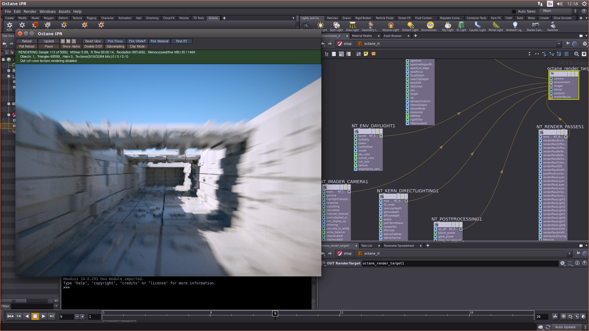

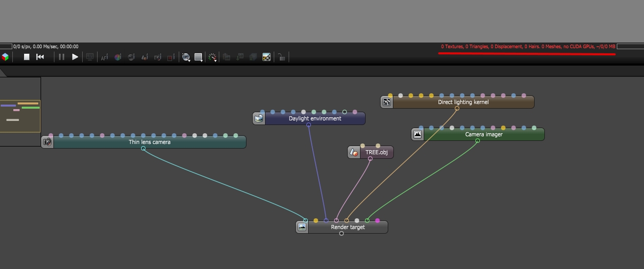

The Houdini plugin development is moving in the right direction. All the Octane nodal system is now working seamless inside Houdini and there are no problems so far. Attached you have two screen grabs to see the plugin in action.
The plugin has a custom SHOP node to store both the Octane render target (the octane rendering preferences) and the Octane shading nodes, integrated as VOP nodes with custom input/output pins. Also the Houdini camera is now fully supported by the plugin.
All the plugin is built around a custom ROP node, and developed using only the HDK with 100% C++ code to make the plugin as fast as possible. It is amazing see Octane rendering inside Houdini, with it's lightning GPU unbiased rendering speed and quality … you are going to love it
See you soon with more news about the plugin development
-Juanjo

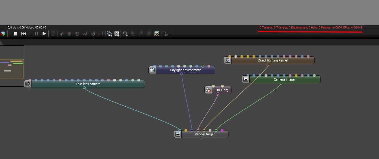

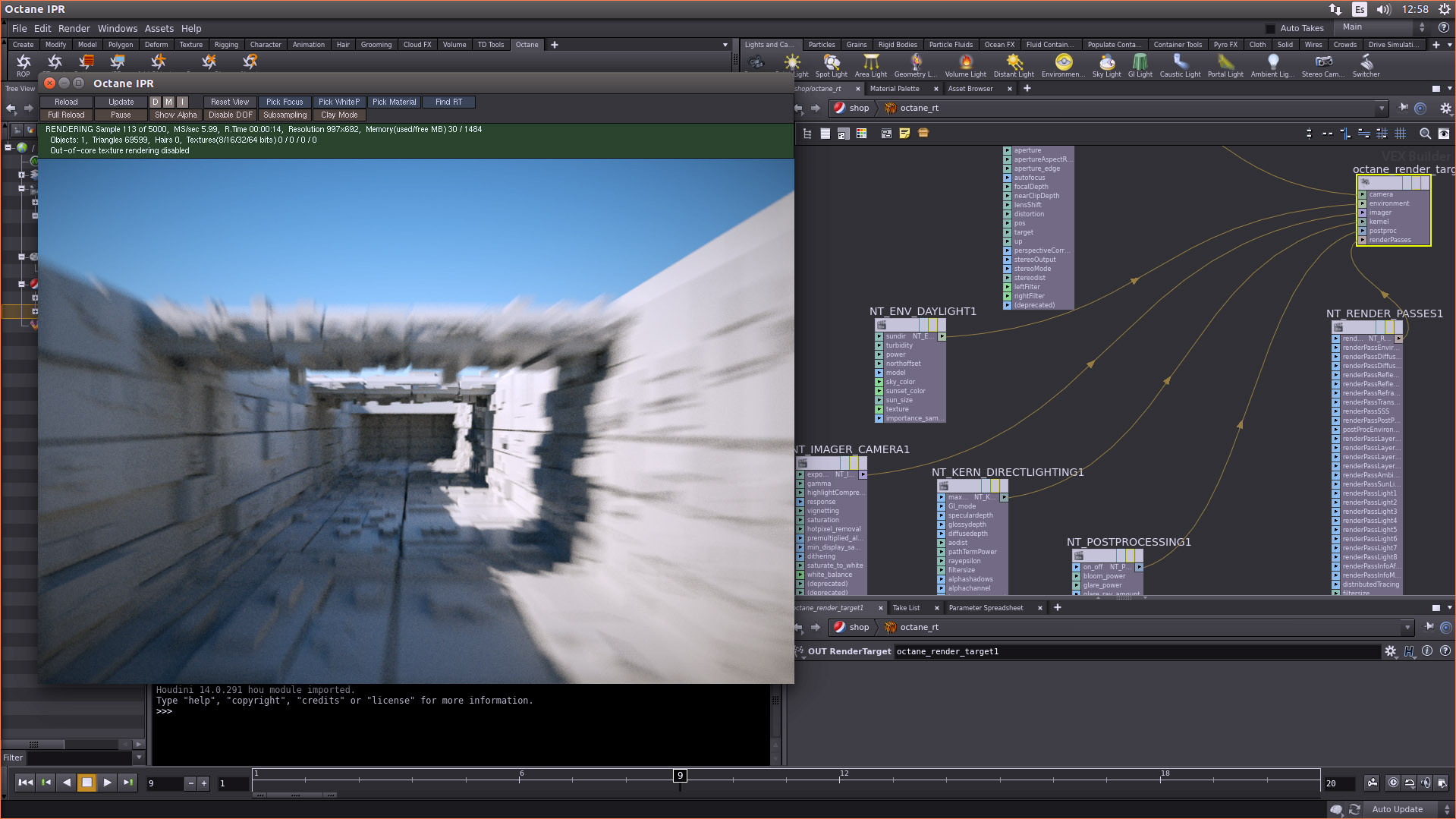

-Juanjo
