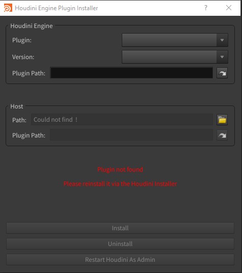

Windows, Houdini latest daily build (708). And I have it correctly on the MAYA_MODULE_PATH.
Used this help file for mod path : (https://www.sidefx.com/docs/maya/_maya__install.html)
Tried the all paths from the default:
C:/Program Files/SideFX/Houdini Engine/Maya
up to:
C:/Program Files/SideFX/Houdini Engine/Maya/18.5.708/maya2018/plug-ins
For this project I need to use Maya 2018.
If I try to force install it via mel : loadPlugin houdiniEngine;
// Error: line 1: Plug-in, "houdiniEngine", was not found on MAYA_PLUG_IN_PATH. //
All the prerequisites seem in the right place, mod file seems to work correct too on the env PATH. Not sure what else I can do.
up to:
