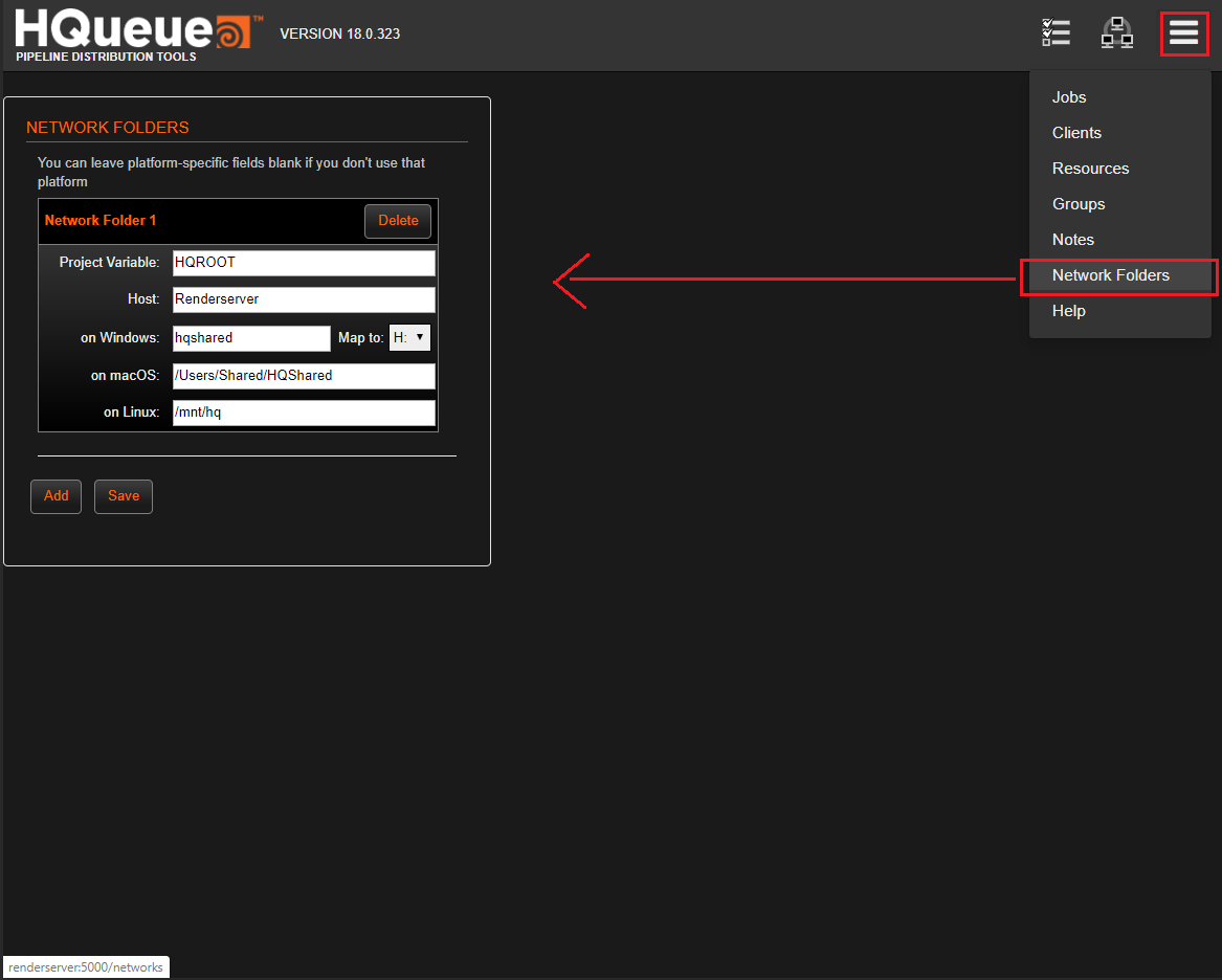

Hi Rob, thanks for the help.
I tried the Network Folders tab on the Server page and was able to change the settings so the network folder error went away. So thanks for that! Don't know if it's a problem on my end, but using Firefox there were no feilds to change, but it worked with Chrome. See image below.
https://imgur.com/a/C2HBHsv [imgur.com]
However, no matter what I tried, the job would fail with the error;
“Loading .hip file //myserver/HQueue/projects/Render_Test/RenderTest.hiplc.”
“ERROR: Cannot find file //myserver/HQueue/projects/Render_Test/RenderTest.hiplc”
I tried so many variations in the network folder feilds to no avail. But it worked as soon as I stopped the HQClient service and ran the hqclientd.bat batch file. I appreciate that there might be something wrong with my config somwehere that stops HQueue running nativley, but for years I've relied on that batch file. Way back in the day when I was first setting it up I read on the forums that was the solution to get HQueue running on Windows and it works. I can't speak for everyone here but as far as I know thats the only way to get HQClient to work on Windows.
If someone could shine some light on getting it working without the batch file I'd be more than happy to not use it. But as it stands, HQueue doesnt work without it, for me at least.
Appreciate all your help!

SkippyLink
Ah, looks like an incompatibility with Firefox. I submitted a bug (101479) for this into our system.
SkippyLink
Take a look at the HQueue Client service on your client machine. The service may be running with an account that doesn't have access to the network folder. Try changing the service's Log On account to say your Windows user account which I assume has access to the network folder (you can verify this by navigating to “\\myserver\HQueue” in Windows File Explorer).
After changing the Log On account, restart the service and see how that goes.

- SkippyLink
- 19 posts
- Joined: 10月 2011
rvinluan
Thanks for the tip but I'm afraid that didn't work.
I can access the share through explorer (as you suggested) when logging onto the service with my local account but HQueue still throws up “ERROR: Cannot find file //myserver/HQueue/projects/Render_Test/RenderTest.hiplc”.
I should point out that the server and the local machine do use different passwords (same username) but I have no problem accessing the share through windows. It is a mapped network drive and i can also naviagate to it using both its name and IP address.
If i remember correctly, in the past the message that you would get was “Access Denied” if the service couldn't log on due to permissions. Here, it simply can't find the file.
Tried again with the batch file and it works.

SkippyLink
“Access is Denied” is one manifestation of a permissions issue but I've also seen “Cannot find file” errors when the Log On account has limited networking privileges as well.
Just to confirm, you can access the network share in Windows File Explorer using the share's UNC path, right? So using “\\myserver\HQueue” instead of the mapped network drive.
Also, here are some other things to try/use:
- When specifying the Log On account in the dialog, try using the “Check username” button (I think that's what it's called, I don't have a Windows box in front of me) to verify and select the user account. It's interesting that you mentioned that there are 2 different user accounts with the same name. I recall another user running into conflicts between the local account and the network account. If I recall correctly, they had to specify the local machine name in the account name by clicking that button to get things working.
- Another option is to specify the server as an IP address instead of DNS, so “\\XX.XX.XX.XX\HQueue”, in case the service's user account still has some limited network privileges.
Also, regarding the Firefox issue. We cannot reproduce the problem in-house. Tested with Firefox 70.0.1. Silly question but does shift+click refreshing the page help?
Cheers,
Rob

Hi Rob
Yep, can access using the share's UNC path, I have no troubles accessing the shares through file browsers.
I'll give the logon accounts a few more tries later today and let you know how it goes. I don't have two User accounts with the same name, my NAS (Where the share is located) and the OS have the same username, but with different passwords so I'm wondering if it's trying to access the share with the wrong password, maybe.
I did try the Check username button and it autofilled with ./username rather than the expected DESKTOP/Username which looked a little odd to me. I'll also look into credential manager to see if anything looks iffy in there. I've tried using the IP address too and it worked with the batch file as per usual, but I'll change it to the IP for the case of troubleshooting.
I'll also reinstall and see if messing around in the “Account to run service under” section works. I have a feeling it might be there….
Firefox is working now… went to check the shift+click and it was already there. Typical
Again, appreciate all your help!

OK! New update!
I changed the “Account to run service under” to my username and password, which immediately failed.
In the service login in section I entered my username and clicked check and it filled with “.\Username”
I changed that to “DESKTOPNAME\Username” and it was able to find the file and start rendering!
Then I get a new error, but new is better…
ERROR: The attempted operation failed.
Error: Could not create output directory H:/projects/Render_Test/render
That directory already exists, so I assume it is having problems with permissions writing to the NAS now?
All i could think to do was add “HOUDINI_ACCESS_METHOD = 2” to the hqnode.ini as that has allowed me to save to the NAS through Houdini normally, but that didn't work in this case.
We're getting closer!

SkippyLink
That's good to hear! About making progress that is, not about the error.
The HQueue Client service is unable to access mapped drive letters so that would explain why it complains about
H:
. I would wager that there is something in the .hip that is referencing a hard-coded H:
path.Here are a couple of things to check:
- Check the Outputt Picture parameter in the Mantra ROP. If it has a hard-coded
H:/
prefix, then try replacing it with a $HIP prefix instead.- Check the Advanced -> Create Directories parameter in the HQueue Render ROP. If there are any
H:/
directories listed therem then you can try replacing H:/
with $HQROOT or remove the directory entries altogether.Cheers,
Rob
