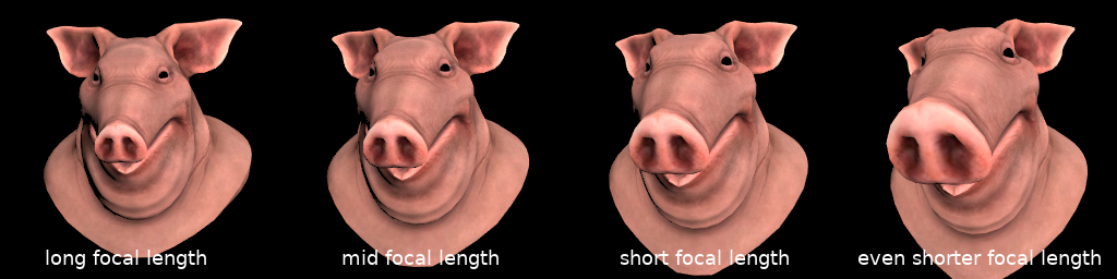

The smaller your film/sensor size is the greater “zoom” or crop-factor will be applied to the image for a given focal-length.
Yes it's ‘good’ that you put zoom in quotes, because doing what you describe is not an actual zoom in terms of real camera/film results.
The better term as which you use is crop-factor. Maybe Up-Cropping/Down-Cropping? or Whatever other term.
Otherwise in addtion to aperature, the term zoom doesn't have the same meaning and effects as well.( In houdini or most other software packages vs. zoom with real lens).
In real effects of camera/film a zooming by the camera also has the effect, in addition to the ‘apparent’ change of cropping factor, is the compression or expansion of object sizes relative to their distances to each other.i.e.,
If you take a shot of the moon that also has some buildings in the foreground, with a 1k mm lens, you will get a much larger moon size relative to the buildings. However, if you take the same shot with a 50mm lens; No matter how much you ‘tinker’ to try and get the same approximate final image with ‘cropping’ (changing your image/film plate size), you will never get the same image. You will never get the same object sizes relative to each other.(In this example Moon compared to the buildings, that comparison in the two contexts - one 50mm the other 1k mm lens).

BabaJ
No that's exactly what it is. Zoom is changing the size of the projection. It is equivalent to changing the size of the imaging device. It is expressed in Houdini in terms of focal length and aperture, since these are the values that correspond to the real world. A zoom value would be just as valid, however since it is unitless, it would make relation to physical camera and lens sizes impossible.
BabaJ
This is not the effect of the lens, but the effect of distance to subject, and the relative distances of subject to subject. Changing the lens or film size only changes the angle of view. The captured image is invariant to focal length or cropping–the same as cropping an image in photoshop.
To get a better understanding, read up on the basics of field of view and imaging.
https://en.wikipedia.org/wiki/Angle_of_view [en.wikipedia.org]

Sorry jonathan, you don't understand what I am talking about. Maybe this link will get you started in the right direction.
https://petapixel.com/2018/07/17/is-lens-compression-fact-or-fiction/ [petapixel.com]
The article in the link is in agreement with my statements and illustrates my point well.
Zoom indeed does change the size of projection. But my point is that with a real life lens that is not the only factor at play.(In what you can and cannot get as the final image).
But to add for clarity, as you still don't understand what I am saying:
Take a scene shot with a camera using a 35mm lens then another shot using the 1000mm.(the same could be done with one zoom lens if it had such a wide range capability).
Now try with whatever means you want, either through an actual physical alteration of the film/sensor plane medium, or software afterwards,e.g. Photoshop, Houdini ‘aperature’ parameter, etc.;
Try and crop that 35mm shot to have the same image as the 1000mm.
What you will find is that, although you can accomplish the same ‘field of view’ through the ‘cropping’. The resulting image will never be the same, due too compression - as what my link I provided illustrates.
So although your link does indeed illustrate your point well, you and your link are incomplete since the factor I am talking about has been left out of the equation which is important to what I was suggesting earlier that cropping an image is not the same as zooming with a real camera lens. Both methods may share affecting the field of view; but both methods do not give the same result as they do not share the factor of ‘distortion’(as per the link).
Are we on the same page yet?

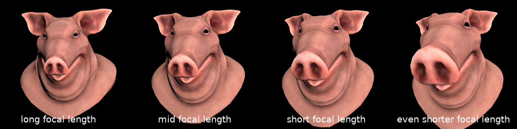

zoom, crop, aperture, focal length are more or less ultimately changing the same thing, FOV
Aperature in Houdini indeed does change FOV. However with a real camera, changing aperature does not change FOV whatsoever.
It only changes the Depth of Field - what is and what is not in focus(blurring - not to be confused with blurring caused by motion), plus contributing towards exposure as well.
