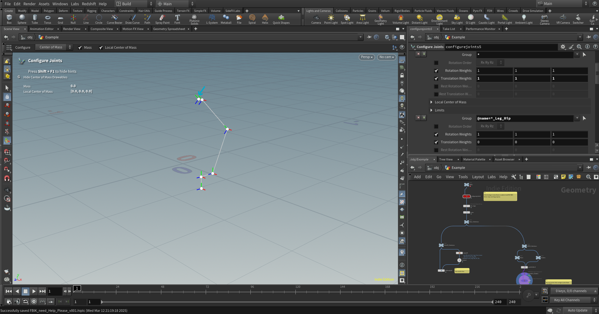

I am now facing another issue. Whenever I use the jointconfigure node, the APEX FBIK solver seems to go crazy. I have replicated the setup in SOPs, where it works just fine. I read somewhere that the APEX FBIK solver currently does not support limits, so in this example I am only using weights. The manual states: “If the weight attribute is used, a default weight has to be applied to all the driven joints before overriding specific joints with differing values,” and I’ve taken that into account as well.
I have no idea what is happening and hope someone can help. I have attached a small example file to illustrate the issue.
