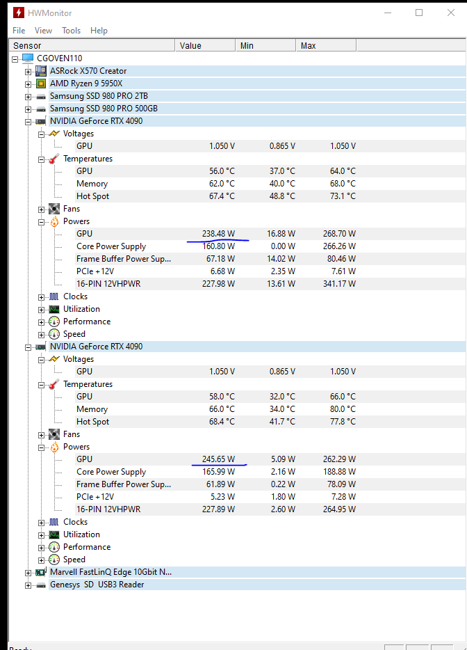

Just to add... trying anothe rproject, two cahracters, hair, inside of pharmacy .. it renders blazing fast and no hickups at all.. all machines rendering clean and smooth..
Can it be something in the scene that is jsut.. too much?
one more thing I;ve jsut noticed.
In this first project where my machine is failing, cpu and both gpus are at 100% usage btu power draw for gpus is poor around 90W
Rendering another project they draw properly power all good no issues. screenshots attached.
