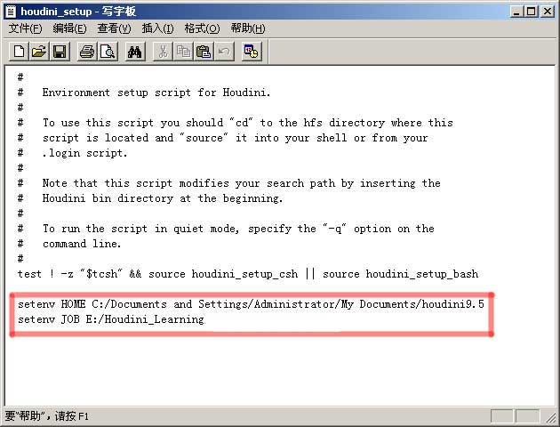

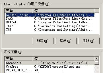

Thank u michael! I created a new environment variable named “houdini_setup”,and the value is “D:\Program Files\Side Effects Software\Houdini 9.5.170\”,Which is my Houdini installed.I'm not sure it's all correct.but it seems dones't work.
Cause I never setup any environment variables in windows system,So I dont know Where I can edit it ,How the system use it?…I know there're too many things I need to know ,but you just tell me How to setup a location of JOB($JOB). For example,I hope my JOB's location is E:\Houdini_Learning.that's all right!
Thank U again!
Thank U again!

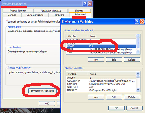

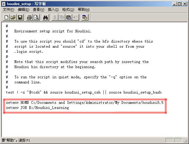

Thank you Edward!It's true I cannt setup HOME's place after i tried.
But I'm not sure i can change the JOB's place to another place such as D
I used way from 2 pics you showed to do it ,but it still in default place,What's wrong with my did,I dont known,
If it should be edited in file houdini.env???
Thank you again!
Thank you again!
