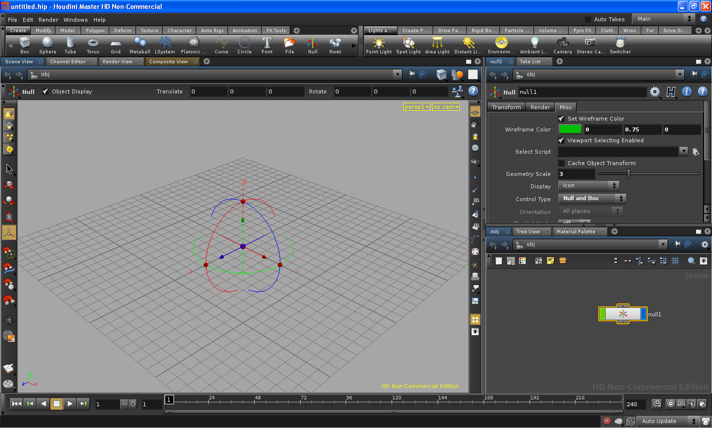

Hi All Houdini People,
Like you see in the screenshot with the new vers.10 I don't see the null
icon ( for example Control Type) in the viewer pane:-
Somebody can Help me?
Thanks in Advance
LabMarino
PS:- The “New” NULL in my vers.10.0.268 has not the control1 % point1
inside like the old but gold vers.9.5
Help:-Null object don't display icon in the viewer pane
10558 18 0- LabMarino

Thanks JC for replay!
But I think we speak different languages:-
First , I don't see any change in the viewer pane when I change the control type (like You say in * SOP * context…..)…..see screenshot…..
Second, there is no changes also in Object context…I don't have a Null-Create choise in the TAB Menu'!
Can You ,please explain what I'm doing wrong…
It really make me crazy because I cannot see the control type like before
in the old version!

I'm honestly having a hard time understanding what you're talking about.
Go to the Scene View that you have displayed in your image(it's in the object context). Hit tab - select ‘Null’ - click down, and you'll have a proper null with the control crosses. Other than that, I'm afraid I can't help you.
What you *are* doing, it appears and as I've already said, is in the *SOP* context you're adding a Null(utility). That creates an object with only a single null SOP in it, as you're showing. The only other thing I can think of is that you've somehow changed the definitions of the actions. Try renaming your $HOME/houdini10.0 directory and restarting, see if you can repro.
J.C.

The Null object should contain two SOPs. One is called control, which displays the geometry, and the other is called point, which gives the location.
If you are saying they are not there, then something has gone wrong in the null creation process.
You can try creating the null by using the tab key and typing “null”. See if that works. If it does but the shelf button doesn't, then there is something wrong in the shelf script.
If it doesn't work when you are using tab then there is a major malfunction.
