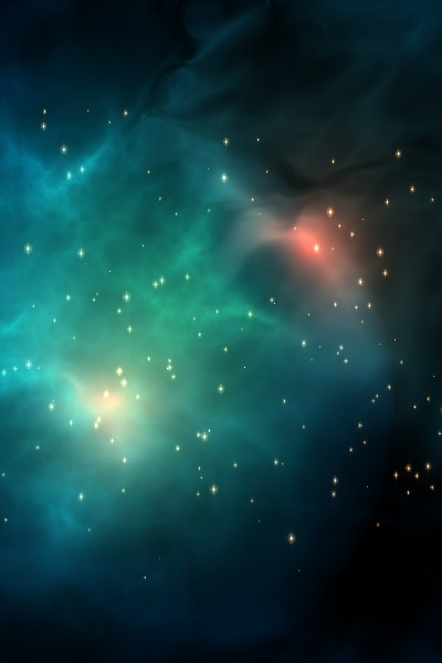

Ohh crap..I forgot, I tested the link, but I was logged in, should have known this of course, Im sorry.
here´s the pics..
I hope I can figure out the houdini way to do this similar, Im suspecting it takes much more setting up thou, and doesn´t have the huge procedural collection as lightwave does thou.
renders very fast, and I just recently installed the new lightwave 10 build with it´s VPR I get to see and tweak this Almost in real time in the viewports.

jimc
Wow, those are all rendered? They look beautiful! While I'm sure you could do this in Houdini, the little I've played with volumetric lighting suggests that something like this would take quite a bit of time to render.
Yepp all lightwave 9.6 renders, approx 5.6 seconds 600x1000 resolution for sample 2, I don´t even get mantra in houdini started to render in that
time, and add the time I have to set up a render node too..in lightwave just hit f9..just one of those workflow things I don´t like with houdini.
with Hv sprites 1 single null voxel, 2000 particles for stars and sprite clipmaps on those, 3 lights with lensflares and volumetric lights activated, the volumetric lights has a sprite mode so that´s why they render fast, and they have procedural textures activated as well.
Thats for sample 1 and 2, the other collection is mostly sprites, and maybe one or two volumetric hypervoxels, but those were slower.
Now In lightwave 10 and VPR I get to see those almost in real time, I don´t think I can show that off yet on a vimeo page, since It officially isn´t out yet, q4 this year is the shipping date.
viewing hypervoxels volume mode in VPR is absolutly Awesome ..almost realtime, Rob Powers who worked with Avatar and now working with newtek showed a nice video on that.
Im sure that even more mind bogglig images can be created through Houdini thou,because of It´s node structure.
The problem Is the steep learning curve thou, and acessing and tweaking sprites doesn´t come close to how fast it works in lightwave.
