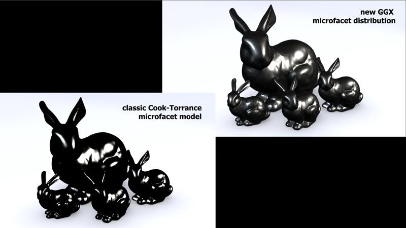

Check this out: http://www.youtube.com/watch?v=Mopk3gqisVI [youtube.com]
Just made an implementation of this paper. GGX specular is so cool!
