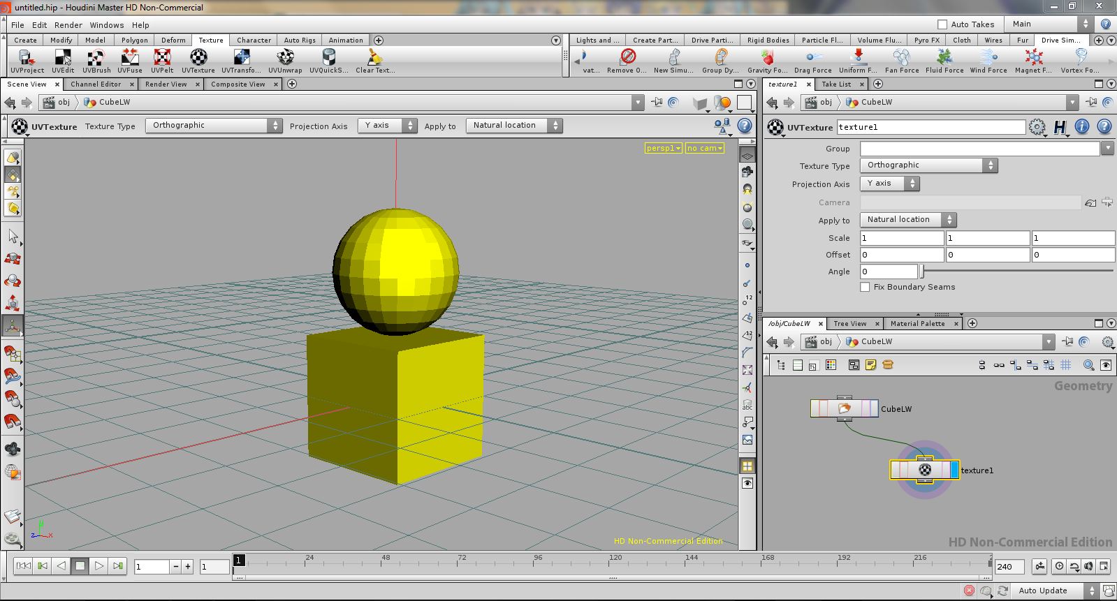

I tried your scene file and had some luck but not a lot. I exported the Geometry in Modeler through Utilities–>Additional–>Export Lightwave 5. I imported in Houdini version 11 and it popped up. I tried adding some materials but no luck. I will continue to try again since this is really bothering me as well. Also UV's were not assigned.
Glen
Edit** I swtched to LW 9.6 64 Bit and exported it the same way as mentioned above. I assigned a material and nothing was there. I did a quick render and everything shows up.
Glen
Joined: Dec. 2010
Exported from LW–>File–>Export–>Export Lightwave 5. Brought the .lwo into Houdini then –>Texture Tab–>UVTexture. I hope this works. Good luck.
Glen
Ball & Cube.JPG (224.1 KB)
Glen
