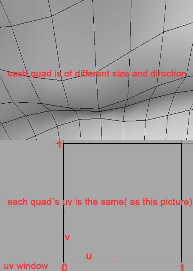

Hello guys, I have a problem for quads polygon uv mapping, now I am designing an architecture with a lot of panels in diffent size and direction in space, and I want each primitive(face) of the quads textured with the same picture. So for each primitive,the uv points shoud fit into the whole uv window(both u,v is from 0 to 1 for each primitive). What should I do in order to get the result. Thanks in advance.
I attach a simple file,but should treat the null object as the initial input geometry. thanks again.

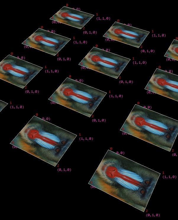

Each primitive has vertices. They are numbered cyclically, one cycle for each primitive. So for 4 sided polys you have vertex id 0,1,2,3 and the next 0,1,2,3 etc etc
The idea is to create a uv attribute that ranges from 0-1 so as to create a coordinate system with 2 axes, one u and one v. So you want the points belonging to two axes and create a value for each pair of points defining the axis edge. The u direction is specified by $VTX>1. So Vertex 0 and 1 are 0, and vertex 2 and 4 are 1 (one pair of opposite edges). So now there is a 0-1 gradient between the two. A similar argument applies for the v direction.
You can actually replace the second expression by $VTX == 1 || $VTX == 2 and it still works (and may be easier to understand), or do one axis as $VTX == 0 || $VTX == 1 and the other $VTX == 1 || $VTX == 2
