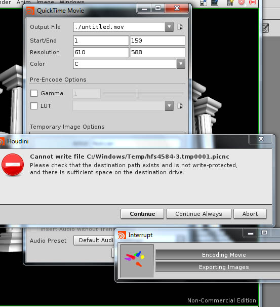

When I try to export a flipbook in apprentice I get a strange error.
I don't know how to fix it,can someone help? thanks
I attached an screenshot..

As the error reports, make sure that you actually have that temp directory in place.
It is asking for a directory in your root c: drive in the following location:
CWindows/Temp/
If it doesn't exist, create it. If it does exist, make sure that you can write to it. See if you can create a folder in there.

it does exist and I can create a folder in it.
(my temporary solution is exporting the image files into AE,but it would be nice if I didn't have to do that for a basic flipbook)

I don't think you can write to CWindows/Temp because it might have special administrative privileges. Try creating a folder CTemp and save your images in there.

I set it to save to a completely different disk,and it still gives me the same error referring to that disk?
I tried re-installing,but i don't think it was a proper uninstall because it remembered all my recent files when I reinstalled it.
