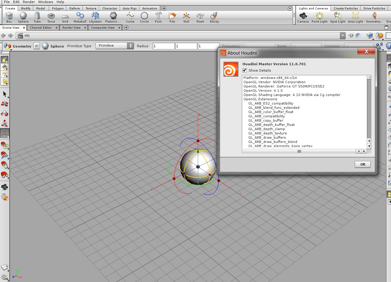

Not really sure what the problem is but you really should be posting your specs. In Houdini, go to the main Help menu and choose About. Turn on Show Details and post the result.

Joined: May 2009
check the attached screen shots. Optimus by default chooses intel. I forced Houdini to use nvidia. I couldnt get to do extensive tests yet.
