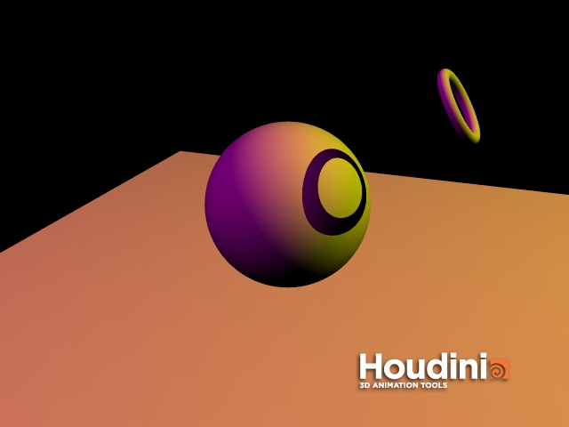

Hi all,
I'm looking for a way to make an object receive shadows but not cast them.
If I turn “phantom” on it will cast shadows but it won't receive them.
So basically if I have a sphere and a cube on the ground I would like the sphere to receive the shadow from the cube but it shouldn't cast it's shadow on the ground
Thanks,
Adrian
153 posts
Joined: June 2010
What about this method ?
I used Torus instead of Box becuase its more cool,
hope it will work for you ;-)
Light_Mask_Shadow_Mask.hipnc (923.7 KB)
102 posts
Joined: May 2006
Many thanks James, yep works for my scene but still, looks like it could get complicated if you have a scene with many objects.
Hopefully SESI will add at some point a simple cast shadow toggle on the object render props… just like the phantom one.
Anyway, thanks again
