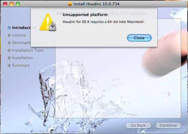

My school uses version 10.0.734 and i wanted to install it on my mac. It is a 17 in., tiger generation MacBook Pro with Snow Leopard (64 bit) installed on it. The message I get when trying to open the install package says that I need a 64 bit intel machine. It is both of those things and it will not run. can someone help me?
Thanks.
Screen shot 2012-01-04 at 1.25.46 AM.png (230.6 KB)
