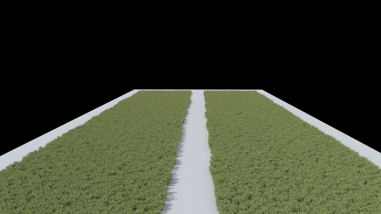

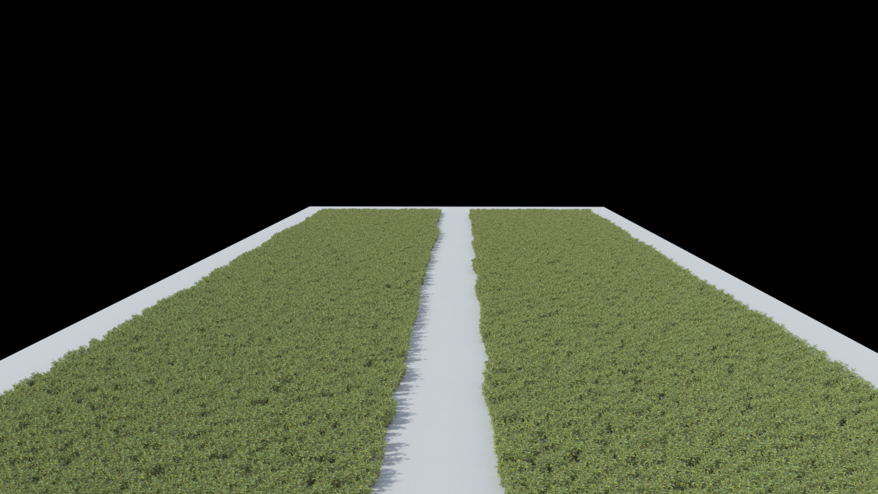

I want to ask for some workflow, if you want to render
50, 140 or 240 mil. polygons bgeo file?
With 50mil poly Mantra use 11GB of memory, with 140 mantra killl my workstation( 24GB).
With instance everything is great 9 trees * 50 000 instance
4500mil polygons - PBR 9min per frame, this is amazing.
But with one big bgeo file…
Igor
Render 50-240 mil polygons bgeo file???
With point instancing everything great 5 trees 90 000 per tree * 50 000
4500mil,i know instance use less memory.
Still same problem kd-tree 0.5, 0.25, 0.1, 0.01 same problem
When i press render mplay using 5GB then on creating geometry mantra use another 5GB and render start.
If i use small patch of ocean 1mil ( bgeo seq) and then in houdini make 50 geo nodes and use this seq as delayed load, but move geo nodes to make one big surface mantra use 0.5GB of ram
