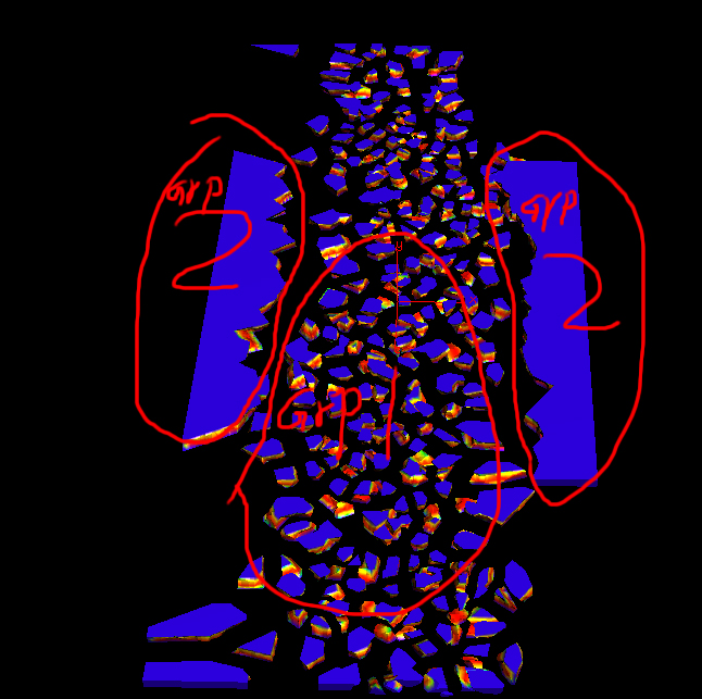

i want to creat two groups with ma fractures ….. on is fracture and the one is
unfracture….what can i do for it? thanks

easy answer: on your “voronoi fracture” node, check the “groups” tab and turn on the option. You'll have a group called “outside” and several other groups called “pieces” and “inside”. I assume you'd want to call the primitives in “outside” as “unfractured”, being everything else in the “fractured” group.

thanks …but this isn't i want …i want 2 Group like this..

Well the fracture sop can already out put the groups. For those tiny bits , you could in a foreach sop measure the area and using a attribute sort them into a 3rd group. or even simpler put everything into one group ^large piece one and ^large piece 2.

Fracture twice.
first ,three piece, output group.
second ,middle piece.
